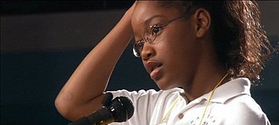

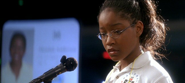

I've shot two features in 35mm anamorphic with the Tiffen GlimmerGlass,"Akeelah and the Bee" and "The Astronaut Farmer". Not for everything in those movies; the first third of "Akeelah" was shot clean but with a lower-contrast filmstock and then I switched to a normal contrast film stock with the GlimmerGlass diffusion.
On "Astronaut Farmer" I used the GlimmerGlass on medium and close shots.
GlimmerGlass is a similar effect as Black ProMist. What I like about it though is that the lightest GlimmerGlass (#1) is slightly lighter than the lightest ProMist (#1/8) and that the next heavier GlimmerGlass (#2) is not as big a jump in diffusion as the next heavier ProMist, so I am freer to alternate between the #1 and #2.
Because it has glitter particles on it like the black specs of a Black ProMist, you have to make sure you are shooting fairly wide-open in video, or not too wide-angle, to avoid the filter surface itself starting to come into focus - it will look like you have a dusty lens.
I had a montage sequence in "Akeelah and the Bee" where I had to shoot the actors in HD (F900) because we had some b-roll of the real National Spelling Bee in HD. It all played in a contained montage sandwiched by 35mm. You can see some frames (attached), the first a shot from the HD footage shot clean -- the second from the 35mm anamorphic footage using a #2 GlimmerGlass. From the DVD. At this point in the story, the GlimmerGlass was part of the look, to create halation on backlight, but I had to drop the filter for the HD shots to match the HD from the real spelling bee.
