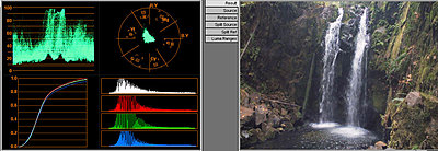

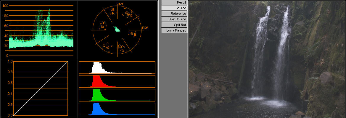

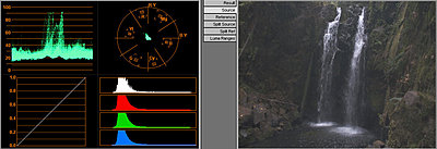

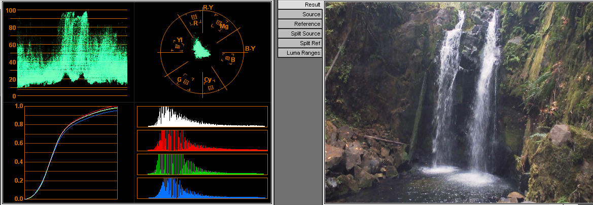

The Ultra Contrast really works very well to maximize dynamic range in the right situations.
I shot some waterfall footage in a heavily wooded area in which exposing properly for bright areas left dark areas black with no detail and exposing properly for shadows left bright areas overexposed.
With the Ultra Contrast 5 attached, I set (100) zebras to avoid overexposing. I also watched the histogram to avoid underexposing the shadows. With the filter attached, the histogram collapsed a bit so that it was clearly narrowing the contrast; everything moved closer to the dark end (left). However, the darkest end moved farther to the right. Stopping down the lens to keep from overexposing the bright areas still left the dark points farther from the left on the histogram (brighter) so that details were not lost. I could not get everything exposed properly without the filter.
The resulting footage came out very flat with low contrast. However, increasing brightness and contrast and adding an s-curve in post created a much better image than I could get without the filter.

Wow, John, I would never have thought that that first image would result in that final product. Perhaps that's why I avoided using an ultracon filter in the past. I guess as long as the exposure is between the limits, there is information to work with. I think the moral of this story is that contrast filters are one part of the equation an should be finished with color correction.
That picture looks a whole lot like Hawaii! Was that shot here? That was a perfect example for me as I know exactly what locations like that look like in real life.
