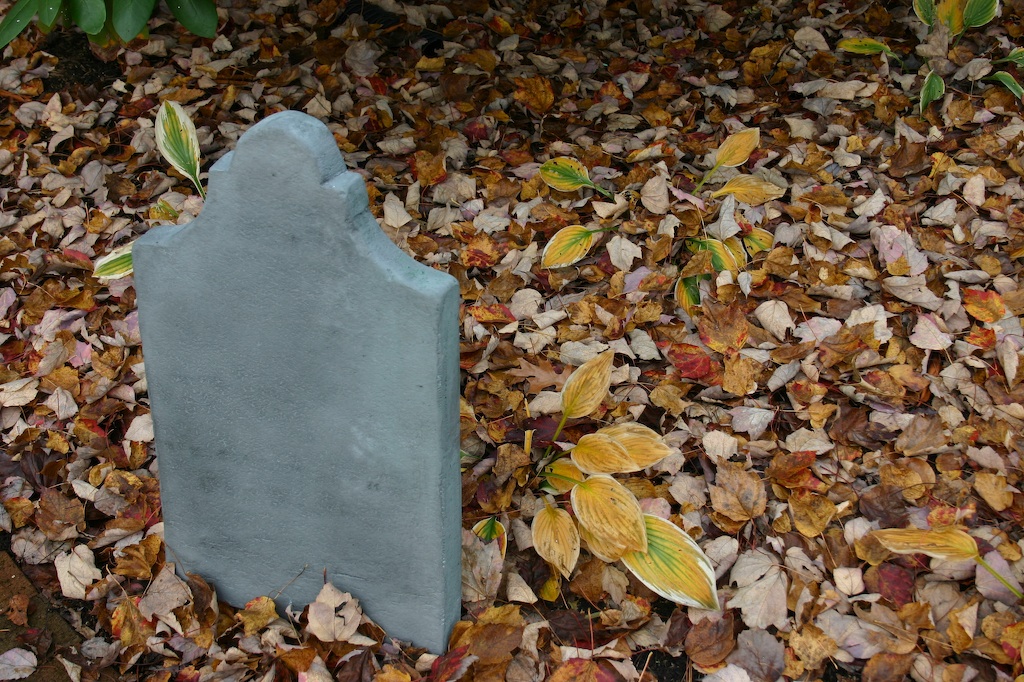

Not as grand as Boyd's, but I made a number of styrofoam grave stones to put in the yard at Halloween. Idea is that they are 18th century so all the names have worn away . . .

Paint on the stones I did is just a high quality grey laytex. It stuck just fine to the 2" blue insulation board. When dry I applied several different washes with thinned down paint to simulate weathering.
