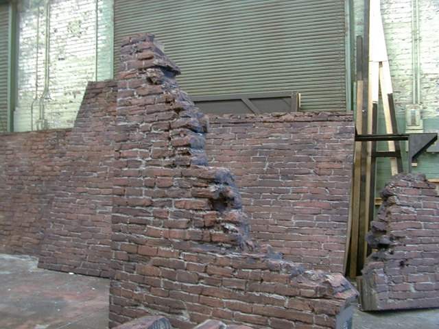

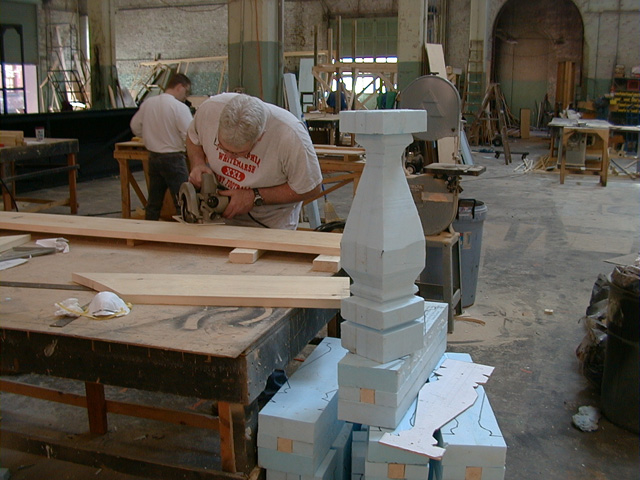

We make stuff like this out of styrofoam all the time, and if you have artistic abilities so can you. There are several types of foam insulation board which should be available from a local supplier - check you yellow pages. Most common is the blue or pink styrofoam and white bead foam. The blue foam has a smoother texture and can be carved and sanded to a nice finish. The bead foam is made from little spheres compressed together and won't give you as smooth a finish but you might like the rough texture. You should be able to find these products as thick as 3", 4" even 6" at a supplier but at Home Depot or Lowes probably only 2" thick. Sheet sizes are either 4'x8' or 2'x8' depending on the product. We have gotten big blocks as large as 4'x8'x2' to carve statues and big stones. If you can't find the thick foam you can glue together layers of 2" foam to get the desired thickness. Use panel adhesive designed for foam board - check the label because other adhesives will dissolve the foam.
A cheap keyhole saw works well to cut it, as do other handsaws. A drywall saw is also handy. Also try a variety of knives for carving, and Stanley Surform files and planes are great for shaping it. Also coarse sandpaper for finishing. Get one of those large circular cup-shaped wire brush attachments for your electric drill and try that - it's one of the most effective ways to shape the styrofoam and give it a smooth surface.

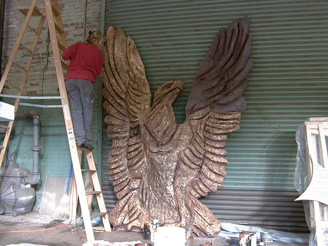

We use a product called "Jaxsan 600" to coat the finished styrofoam. It's a rubber roofing compound that is really tough. It protects the styrofoam if you put it on heavily, and you can add more texture by adding styrofoam dust or sawdust to it. Contact the manufacturer, Plastics Coating Corporation at 304 755-9151 for info.
Here are some examples of how we use it on the stage:

Thanks! The big face, the eagle and the brick wall all consist of plywood covered frames with styrofoam layered on top. The balustrade spindle has a piece of wood running down the center which allows it to be a structural support for a railing. Styrofoam (especially the blue/pink variety) is actually very dense and tough. You can walk on it as long as there's some sort of plywood base underneath.
There are other techniques for covering/protecting the styrofoam. A traditional method is using cheesecloth soaked in glue (such as Elmer's white glue) and wrapped around the foam.
