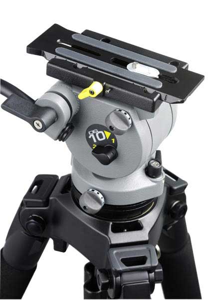

Humm, there is no counterbalance selection switch on this unit.
David Morgan is offline   Reply With Quote
Old April 8th, 2008, 09:06 PM   #15
Posts: 3,698
Images: 18
Hi David..............
You have, most definately, been sold a pup, my friend.
That is not a DS 10. I don't know what it is, but I can tell what it isn't.
If it was sold as "a Miller DS 10", you have definately been had.
CS
PS. This is a Miller DS 10!
