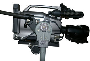

I've always found that conventional heads just don't work too well for aviation. I've been using a post head for quite a few years now, and although I've got some conventional heads, I use this one all the time. Quite old now really. I've included a small image, for those who have never seen one. The clever bit is that it allows the camera to be tilted from it's centre of gravity. No springs or clever counterbalances required. It can, if you set the pan handle properly, let you tilt up to vertical, and beyond - so following an aircraft that goes up, up, up is quite possible. It's also really good for other sharp up angle stuff, like edge of stage, in the pit. Most conventional heads, when tilted up at steep angles feel very different to straight and level. Post heads don't. As it doesn't use springs or anything other than decent bearings, it can be set to as heavy or light friction as you like - I find that a light setting works well for me. From time to time they come up on eBay - but still fetch serious money. they're also quite heavy items, so you need a decent set of legs to stick them on - but if you ever see one for sale, I'd seriously suggest they are worth a look. The one I have is a Vinten Cygnet, although there was also a Swan version too, but they are rarer second-hand.
