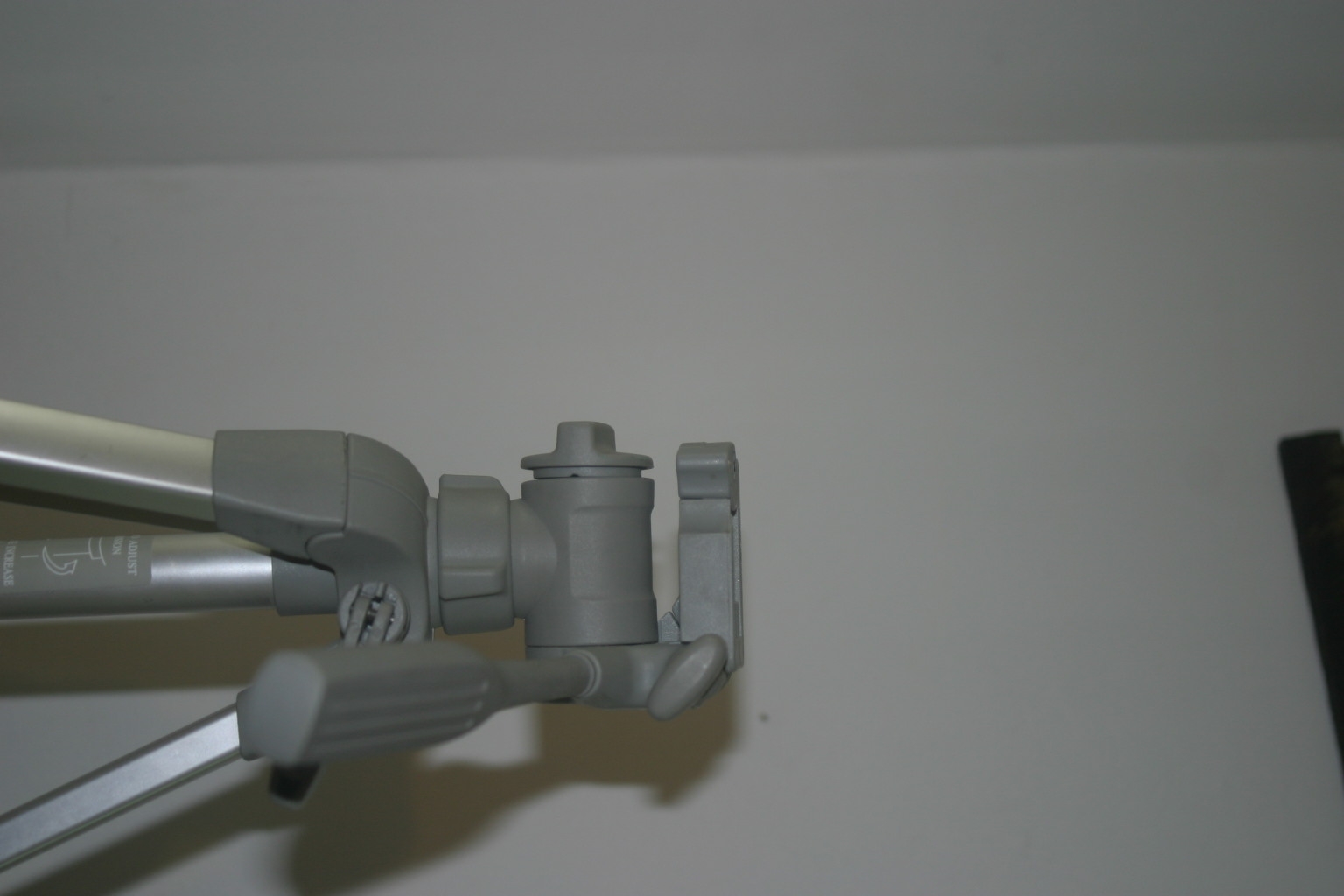

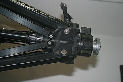

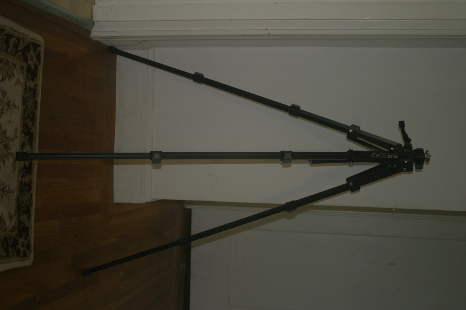

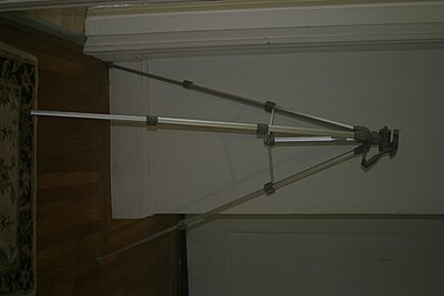

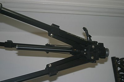

Any other recomendations on B&H kits are greatly appreciated. Attached I took photos of my other 2 tripod. The black one is a Slik 504QF (no Head) and the silver one is a quantum QSX 700I, I think. THis tripod has been very good for a $40 tripod it has a built in level. The head is not as fluid as I would like and it takes a while to get the level just right. This one also has a quick release head and spiked feet.
The Slik is a little beefier tripod. I wonder if I could use a 501 head with it?
