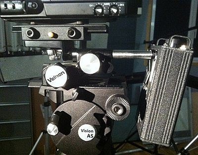

In a nutshell, has any solution be found in order to balance lighter cams on Vinten tripods that require more weight or higher COG?
I mistakenly though my 2.5 kilos system would work on a 3AS, but only too late did I realize that the low COG of my system would play against my calculations...
ie: minimum weight on a 3AS with a system with a 50mm COG is Around 4kg...ish...
SO what about the 'elegant solution' imagined by Chris? HAs that project been dropped?
Do we have any other option?
Thanx for any input

Thanx Chris and Mike for your comments and suggestions.
@Mike:
You said: 'I wonder if it is an option to exchange the head for a VB?'
I've actually just done the opposite! I initially ordered a Vision Blue, but I exchanged for a 3AS. I won't go into the details, but I thought it was a better solution for us.
Also, we use a few systems, and will probably upgrade them all soon to heavier, higher COG ones (AF101 based systems) So the 3AS seems perfect for that task.
Only right now, it doesn't work with the cameras we're using. (DMC151 or VDSLR and various accessories). They're all low COG and weight within the 3Kg range. (the 3AS minimum weight requirement is 4 kg for low COG systems).
You said: 'what about buying a number of Manfrotto 357-type adapter...'
Not such a stupid thought actually. In fact, I was about to start experimenting with that...
The idea was to use a 357 and mount it on top of the Vinten 3AS plate. The 357 plate would of course be mounted to the camera. The COG would then be higher by about 2 cms, which would not be enough. BUT, and that's where it gets interesting, I could use the side holes in the 357 (normally used to keep your extra plate screws) to hold a number of things (second SMall HD monitor, extra mic for backup, a Sound Devices MM1 or plenty other stuff...preferably heavy!)
This should take me to the required weight (hopefully!)
One definite drawback of using the 357 adapter is that one would loose the benefits of side loading that's so convenient on the 3AS.

Ok...
Got it working now.
Here's what I did:
I used a Velbon micro adjustment head I had lying around coupled with a Manfrotto 357. The 3AS plate attaches to the bottom of the Velbon. The 357 plate attaches to the camera.
See the picture for more info.
The good thing is this gives me a lot of freedom for adujting the balance of the whole system (micro adjustable!), so adding or removing an accessory is really easy. Also, it gives me rails onto which I can attach various things (here with a SD MM1).
Also, since I'm nowhere near the maximum weight limit for the 3AS, I get the whole 90° range for tilts (which I could never do with the Vision Blue, which would be approaching its far limit with a MM1 attached)
The only annoyance with this workaround is that I no longer have the benefits of the Vinten side loading system for the camera alone.
Hope this helps.
Thanx and good day to all...

As for the solution I found for the 3AS, it's OK, but not perfect yet (stable enough for field use?). Being a self confessed perfectionist and a decent DIYer (can we say that?), I'll keep refining the concept.
Of course, I'll report back here.
