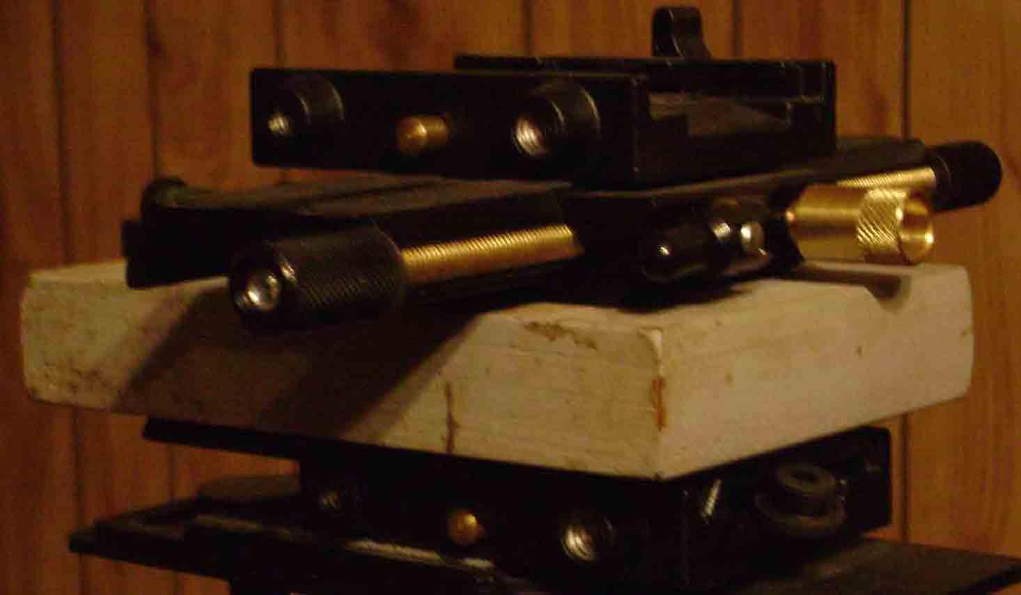

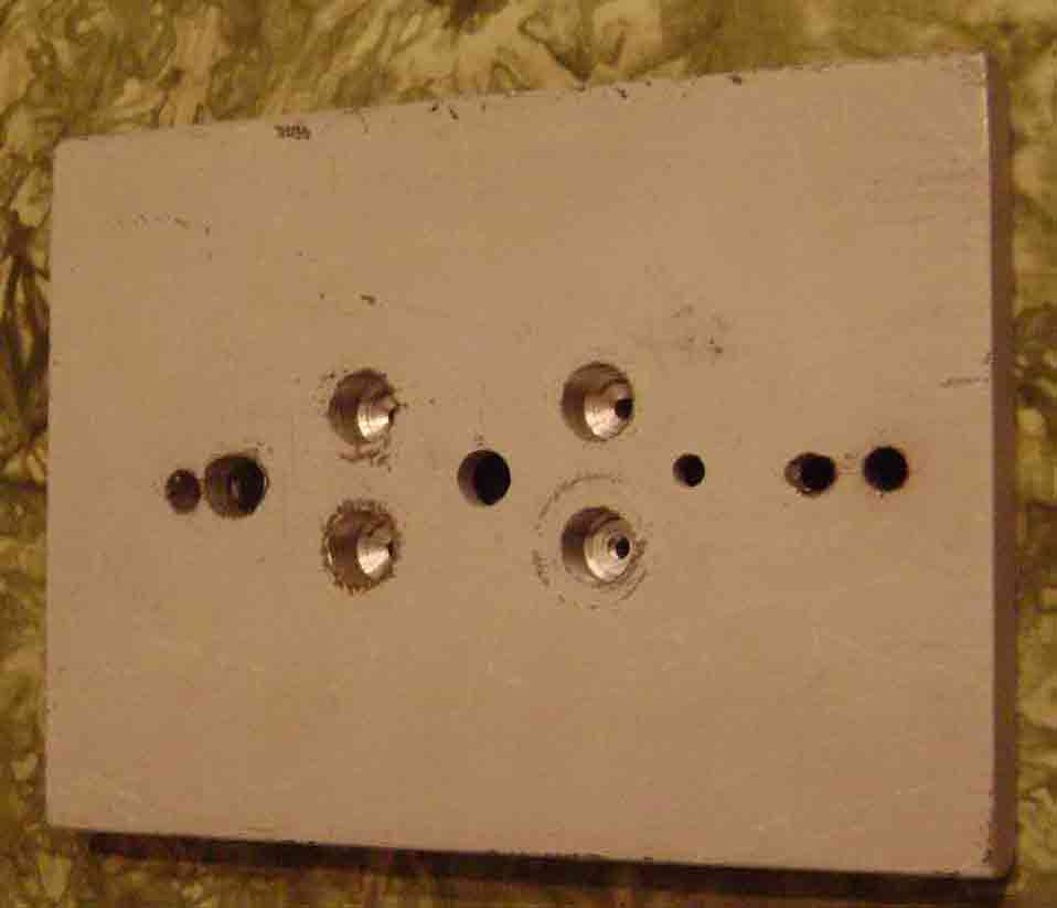

When I first got my vinten vision 6 I had a light camera and a heavy camera, both canons....
the solution was simple: I placed a manfrotto 357 pro on the tripod and I cut a piece of 1 in thick steel 4 x 6 inches, placed a 357 on it and the other piece under the camera. This way when I used the big xl2 I put it straight to the tripod, if I went to the smaller canera I popped on the steel plate and then the camera. then it weighed about the same as the xl2 and required alomost no change in settings!!
The plate is now used on my steady cam to add weight to it so it floats better, so I do not feel like I waisted my money at all.
also even the xl2 with the added weight (which then was about 15 pounds combined) was actually better in several ways such as in wind or in making drawn out pans.
the piece of steel was 8 dollars and the 357 is about 40 bucks, worthy investments.

That's great. Do you have any pictures of that set up in action with the smaller camera? I assume the was a small amount of milling that had to be done, like tapping a hole on the bottom of the plate to attach to Vinton FH and a hole on the top to attach the manfrotto 357.

the on picture is of the plate with holes drilled for the 357 as well as a canon quick mount. this plate is 12 pounds and can be used on the sled or the tripod. i do not use it very often compared to the smaller weight.
My smaller weight is 6 pounds and is shown on my indie cam. I can pull it off and slip it into the 357 on either of my tripods. this six pound weight has been very useful. In heavy winds I can also set them on the tripod and it helps with steadyness quite well as well.
