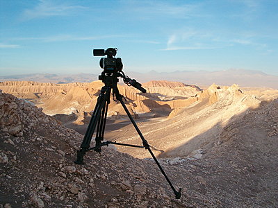

Well you are right about weight but at the same weight the manfrotto is a piece of junk ( except for the leggs), so my question really is what brand, model would best fit my needs...I need to get as light as possible ideally carbon fiber, and a head with smooth pans (which the manfrotto can not give).
I am posting a picture of the place so you can have an idea...
