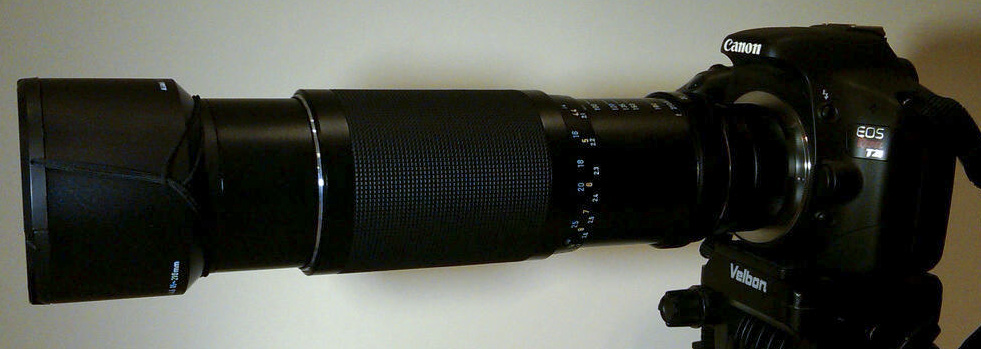

In your original post you asked for criteria to include in your test. In addition to general handling of a typcial 4-10 pound traditional camcorder. I'd like insight into the tripod's ability to balance and perform with the extreme front-CG caused by DSLR's with long lenses. Can we get true pro performance for under $1,500?
This picture demonstrates the new challenge of DSLR's on tripods (all-metal SMC Takumar 85-210mm):
Short answer - maybe.
Long answer - Going to be a struggle with that particular lens, but maybe just do-able.
As you can see from that lens' construction, there if no practical way to get an attachment point anywhere near the vertical COG of the entire setup.
Thus you're left with mounting the camera waaay back, almost certainly beyond any adjustment you can get with the slide plate, no matter how much fiddling, tho' I wouldn't bet my life on it.
So, you're talking of some sort of rail system, and the clock starts ticking on the support budget.
This leaves you with another BIIIG problem.
The entire weight of that lens is being applied (unless someone has come up with a better camera attachment system I don't know about) to one poxy 1/4" screw insert in the camera base.
That insert can't be more than 3/4", say, from the lower front edge of the camera base.
In effect, that huge lens lever is trying to:
a. Pull the 1/4" insert clean out of the camera base.
b. Warp the lower front edge of the camera base plate.
c. Pull the entire base plate off the camera.
Whatever is taking the worst of the strain is going to allow that lens/ body setup to do a startling imitation of a nodding donkey.
The only way around that, looking at the lens construction, is some sort of intermediate adapter between the lens hood and the lens bayonet mount, that allows a support rod attachment down to the rail system.
Job done - if such an adapter exists or can be manufactured. Support budget clock just keeps ticking.
Then you run up against what might be the giant killer.
Standard video heads use a pear shaped cam to apply ever increasing amounts of force to a spring system of some sort.
The profile of that cam dictates just how much force is applied at what tilt.
I won't go into the details, but "yer average" head is designed for a camera COG of either 100 mm or 125 mm above the head plate. Some of the newer ones are quoting COG well below this and undoubtedly have different profiled cams to standard systems.
HOWEVER, whether anyone has profiled a cam that can work with the extremely low COG as presented by that monster, I can't say, taking into account you now also have a rail system "up top" as well.
So, what to do?
Give standard spring and cam heads the flick and go to something like the Varizoom COG head instead.
VariZoom ZeroGravity (Zero Gravity) Tripod Head, Tripods, Lens Controls, Camera Stabilizers & Supports, Batteries, Monitor Kits - Phone: 512-219-7722
Because the camera/ rail system is mounted at exactly the systems horizontal and vertical centre of gravity with respect to the pivot point, the only thing required is some tilt drag to stop the entire setup turning into a propeller in a breeze.
Of course, getting it set to that pivot point is a PITA and if you're making constant changes to the rig config, it will drive you completely demented.
Personally, I'd go for one in a flash if the setup, adjustment ease and bearing quality were perfect (oh, and I was using anything like that monster rig in the piccie).
At this point in time I don't believe they've cracked those problems, and I've only got a little old Canon XH A1 to play with anyway.
BUT, it might just be the answer to those long lens prayers for you'se guys.
It's cheap too, so you might just squeak in under that $1500 even with rails and front of lens adapter.
Nothing to lose by checking it out.
I think my short answer may have sufficed.
CS

Balancing the Canon with the Takumar 85-210mm
I dont know for certain, but i suspect you could use the Vinten extended camera slide plate with the 1/4" screw and get somewhere near. The camera body could be attached one end of the plate and itll allow you to slide the body way back. It'll only fit the Vinten heads though.
Vinten | Extended Camera Slide Plate with 2x 3/8 " Screws | www.vinten.com
Peter Harman is offline   Reply With Quote

Thanks. I'll try to determine the CG and see how that matches up with the extended plate. If I were to buy today, I'd probably go with the Vision Blue if I knew it would work with these type DSLR set-ups.
Chris,
Thanks for the mention of the Zero Gravity unit. I saw it when it came out and I was shooting with an A1, but hadn't really thought about it for using with a DSLR, which makes sense. There doesn't seem to be a lot of thoughtful reviews or even informal feedback on that particular unit. Has it been favorably accepted by the pros?
Roger Shealy is offline   Reply With Quote
