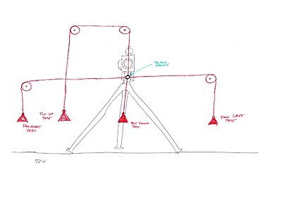

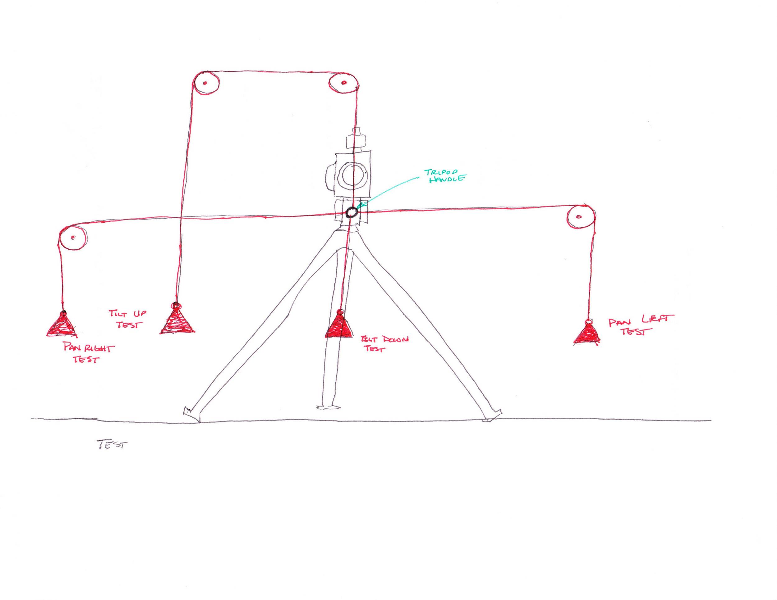

Chris,
I am so glad you are doing this, I'm ready to purchase my first serious tripod and want to get it right. Not sure if you're looking for input on what to test or ways of testing. My major concern is smoothness of slow pan and slow tilt and the lack of spring back when pressure is relieved. Knowing you have infinite talent, time, and budget, it would be great to test each tilt direction separately and in concert with each pan direction both during movement (releasing weights to fall) and after releasing tension (burning string to sever).
Roger Shealy is offline   Reply With Quote

Hi, Roger.................
All and any input is appreciated, the more the merrier.
Not sure about the "infinite talent, time, and budget", big mouth is all, or at least, most.
As I said in an earlier post, the equipment to test this stuff is available to all the manufacturers (that I'm hoping to review) that I'm aware of, and I ditched attempts to make my own as it was early days before I'd managed to get onto any of the manufacturers radar.
Things are different now, but untill I am in a postion where I know there will be a steady supply of new gear to test (which I sincerely hope will happen, especially if I can pull this off) I simply can't and won't invest time and (lots of) money re - inventing the wheel.
So, as it stands, unless one of the manufacturers concerned care to ship me one of their test units (exceedingly unlikely) you're stuck with my take on the units handling (subjective tho' that may be, much to my discomfort.)
HOWEVER, as I am probably the most anal retentive shooter in the known Universe when it comes to camera support handling, if there's a flaw, it will be noted.
Can't really say fairer than that.
Because of the lack of indepent scientific verification, I must rely on sheer skill on my part to sort the wheat from the chaff here, DVinfo'ers either take that on trust or not.
I am very aware that hundreds of people brouse this site daily and take the information contained herein seriously indeed.
As such, my responsibility for every post or review is huge, and I take it extremely seriously indeed when doing any of them.
I don't think I'm going to let anyone down here, if I say so myself, I'm bloody good at what I do.
Heck, let's see how it pans out, I still haven't got all the pigeons in a row yet, they're a particularly hard bunch to coral, even for me.
(And it would appear that my UK "fixer" has gone AWOL for reasons unknown, I'll find out eventually)
Thanks for your input, Roger.

Chris,
By the way, I really enjoyed your article on the Vision Blue. There is no substitute for your hands-on appraisal; wouldn't want to forfeit that for the best test gear. I'm a bit upside down from you, I research, develop, and test equipment as a profession and pursue videography as a hobby.
I spent a little time this morning trying to rig a poor man's pan and tilt tester with a graduated target across the yard to measure spring-back. It totally bombed. I think your instinct was right that without sophisticated gear it is totally up to a set of talented hands and eyes. No pressure but we're all counting on you!
