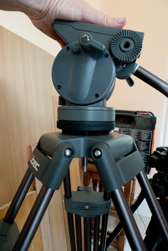

I have a baby gitzo system tripod which I had expected to use with the 75mm claw ball head from my Libec 38 tripod. However, I'm told the bowl adapter for the gitzo won't work with the tripod head. I haven't had a chance to see why not - I can't afford to keep buying stuff without knowing it will work first. So if anyone out there knows . . . . . .
I also bought a set of Manfrotto short legs, 100mm bowl with the 75mm adapter as shown in the video. Again the Libec head doesn't fit.
So I've found out the hard way that, while things should be interchangeable, they often aren't. Try before you buy if you possibly can.

Originally Posted by Annie Haycock View Post
"......with the 75mm adapter as shown in the video. Again the Libec head doesn't fit".
about this.
The Libec RH 25 head I have here is a standard 75 ball base, and is easily interchangeable between the Sachtler, Vinten and Manfrotto 75 mm bowl tripods I have for review (yes, I just tried it on all of them. Not a lot of movement on the Sachtler but then again, none of the other heads have either).
So, how come a standard 75 mm ball from a Libec 38 "doesn't fit" a Manfrotto 75 mm bowl?
Clamp bolt too short? Clamp cup too large?
Enlighten us, Annie.

Sorry Chris - I got called away before I'd found the pictures:
The libec picture (top) shows the head and legs as they should be - lots of bolt showing through
The Manfrotto picture (bottom shows the head sitting high up in the adapter ring, and no bolt showing through.
I have used it without the adapter ring, but there is very little levelling adjustment available before it throws a wobbly (literally) because the head barely sits on the rim of the bowl.

Been here before, 'tho not with this combination.
Somewhere deep in the bowels of this Forum is a thread addressing just this problem, with workarounds.
From memory a web site was trawled up with all sorts of adapter ring sizes that would allow the ball to sit lower in the bowl.
If you can find it (must be at least a year old, if not more) it might just be your answer.
You could try trawling through all my past posts (yeah, of course I partook) or Tripp Woelfel (I think!), tho' God have mercy on you, there's thousands of 'em.
I'll have a look myself later, but as it's only 9 AM and already 28 Celcius, I'm getting out of this computer room NOW!.
Happy hunting.
CS

Thanks Chris - certainly sounds like the same sort of problem.
I did actually email b-hague a couple of months ago to ask if they could machine down an adapter to fit, but they didn't reply. Guess I'd better try them again.
With regard to the Gitzo 75mm bowl - there was the G1422 which has now been replaced by the GS5320V75. They seem to be slightly different shapes - any idea if the Libec head will fit either? Our local camera dealer asked his supplier who told him no - but maybe that was the older model, or maybe he just didn't know!

The Hague 100 mm to 75 mm adapter is different to the Manfrotto and MAY do the job all on it's own - it's not going to break the bank to give it a shot.
If that is a bust, they (Hague) have the facilities to machine a mm or three off the adapter, to either, let it (the adaptor) sit lower in the bowl or the head to sit deeper in the adapter, take your pick.
Shouldn't break the bank either.
