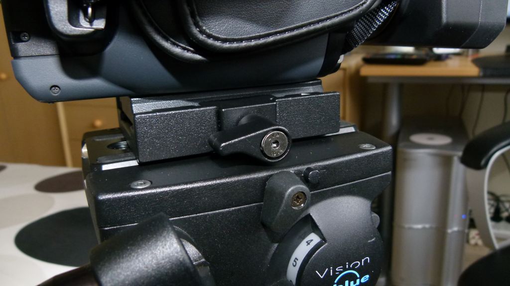

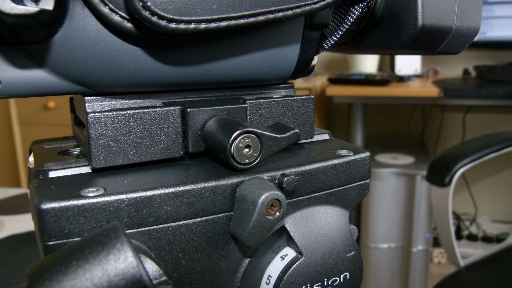

Well there you go, it was (c) after all!
It is possible, just! Another few mm and it wouldn't have been possible to do more than a 1/4 turn, but I can _just_ get a half turn on the knob and it's enough.
I do seem to recall this wasn't possible on my HMC41, which was a "fatter" camera, but I can't confirm that memory because that camera has gone far, far away.
Happy days!
