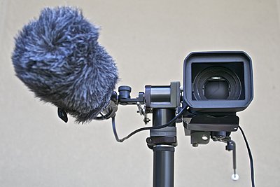

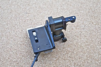

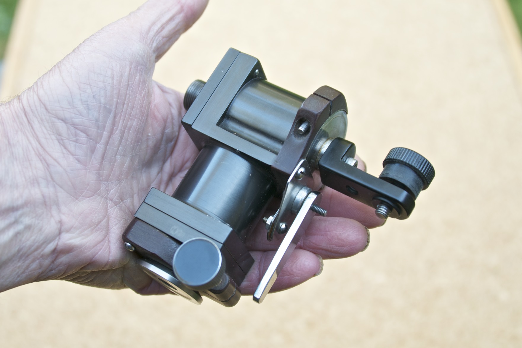

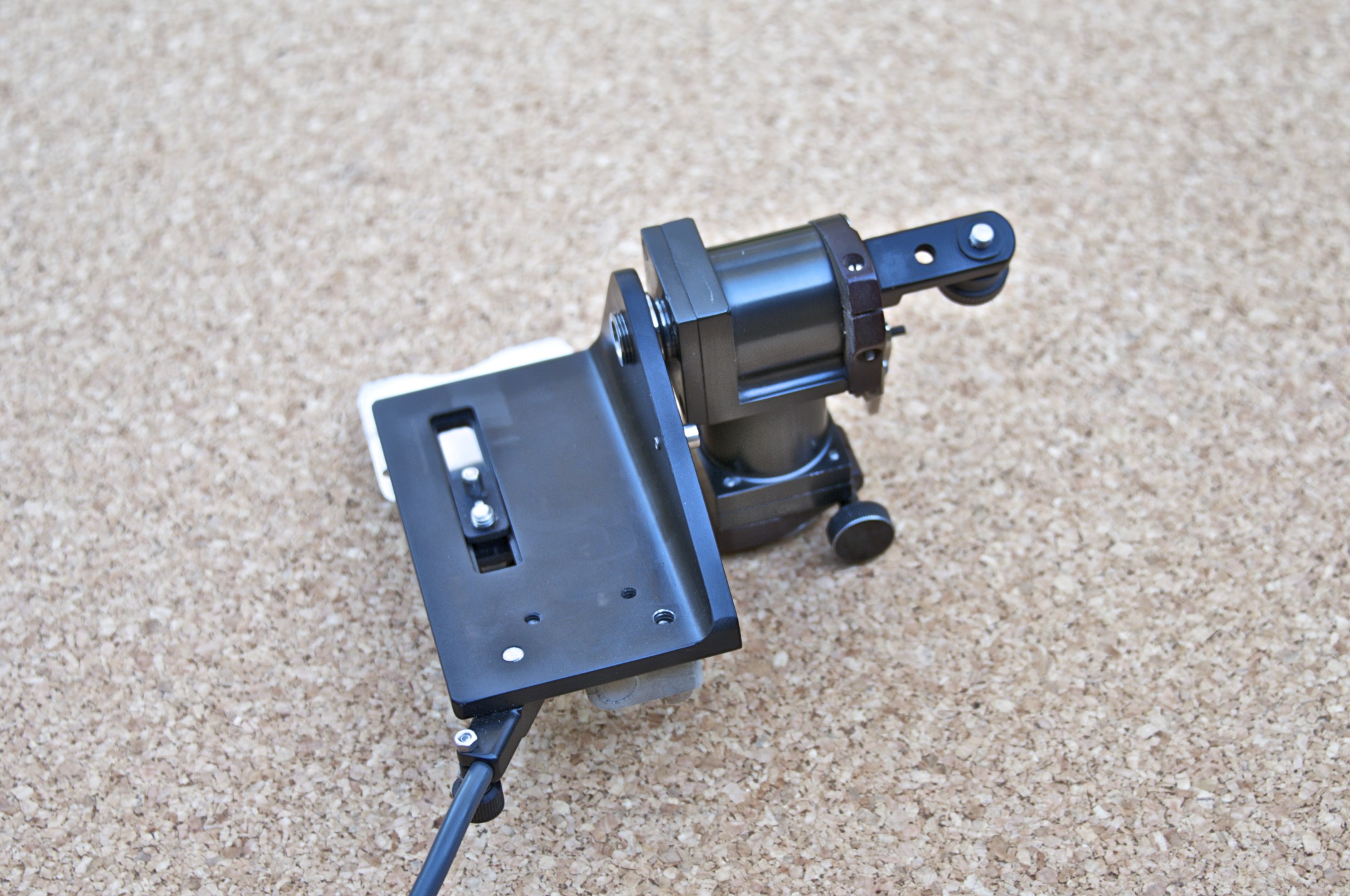

Below is a picture of a small fluid head. Had I doubled all the important dimensions it would have had 10-20 times more drag, i.e. there is a heavy penalty on drag for reducing size.
To keep it simple it is a nodal type head, that is to say the tilt axis aligns with the centre of gravity of the camera so no balancing mechanism is required. The microphone is also aligned with the centre of gravity for the same reason.
There is a benefit in having low drag as there a corresponding reduction in torque applied to the tripod during panning and tilting so that a lighter tripod can be used.
An advantage of the nodal type of head is that it can be inverted and so permit use very close to the ground.

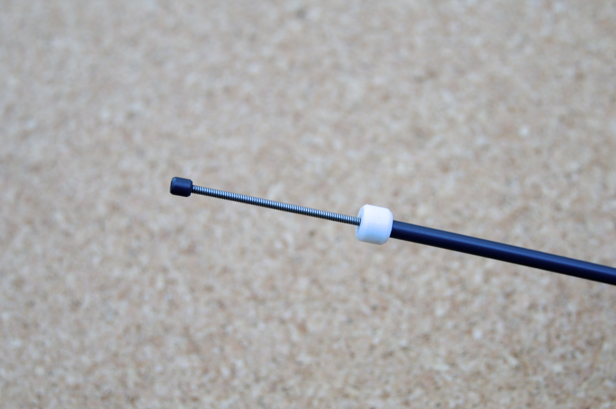

To compensate for the very low drag this head is fitted with a very flexible handle that goes a long way to reducing hand borne vibrations - a sort of permanent rubber band. At the end of the handle there is an even more flexible stainless steel spring fitted with a sliding Teflon roller. For a quick pan the plastic handle is used and for a slow pan with a long focal length lens a point somewhere along the stainless steel spring is used. It is obviously not the sort of handle to fit a control unit to, instead I use the IR remote with or without an IR remote extender.
The camera shown is the TM900 that has a ridiculously long electronic zoom only useful for testing tripod heads. It is possible to achieve reasonable pans at 30x and possibly 40x i.e. beyond the useful range of the lens.
