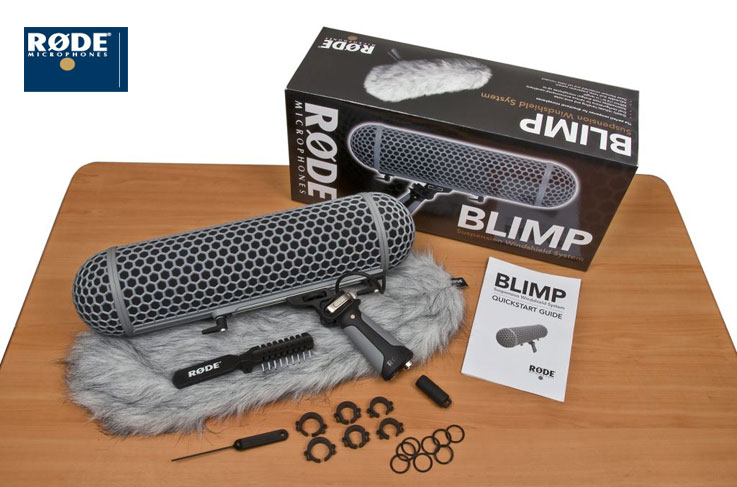

More usefully, I used a Beyerdynamic boom mic stand for one outside shoot where I needed to pan the camera and the blimp at the same time. It did need me to pan the camera with one hand but it worked OK as they was no need to follow focus.
