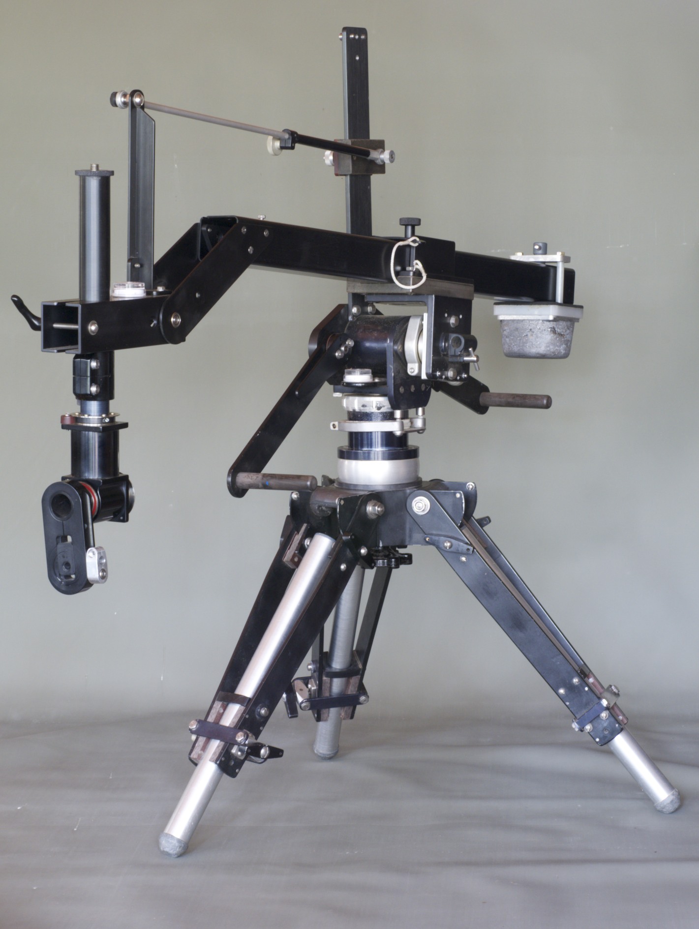

Keeping your O’Connor out of the water seems a good idea. Although you did not explicitly say so I assume you want to use an unprotected camera as close to the water surface as possible.
In the absence of a waterproof head have you considered using a ‘nodal’ style head? These align the center of gravity of the camera with the tilt axis and have the advantage of being able to be used upside down. Below is a photo of one attached to a boom. Although not shown the camera platform attaches to the lowest point on the inverted head so that the camera and working parts of the head at the same level.
In my previous post I mentioned using an early Miller head below several meters of sea-water with no adverse effects other than the one mentioned. I should have added I discussed the idea with Miller first and received a lot of encouragement from them. The Miller was replaced over 30 years ago by the one shown. Although it has been ‘re-arranged’ several times over the years for different projects the pan and tilt sections are still original. http://www.dvinfo.net/forum/images/attach/jpg.gif
