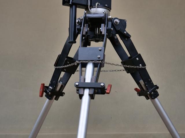

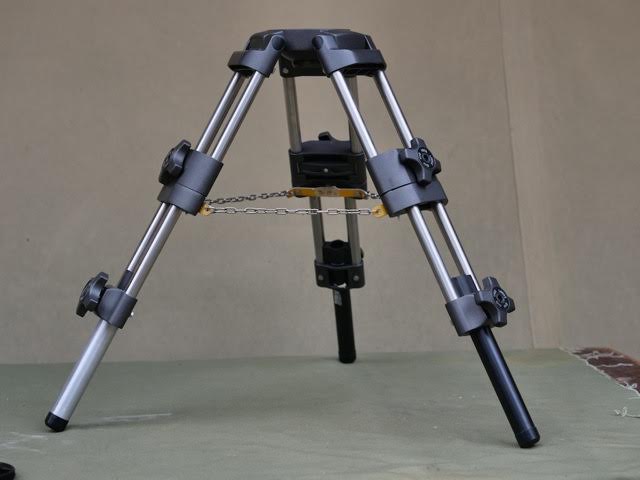

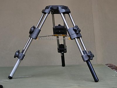

Posted on behalf of twice-decorated sterling member Alastair Traill, due to image upload wonkiness. Message to wit:
"My reply was to Pete Cofranesco in the Tripod section of DVInfonet headed 'Sachtler Spares’.

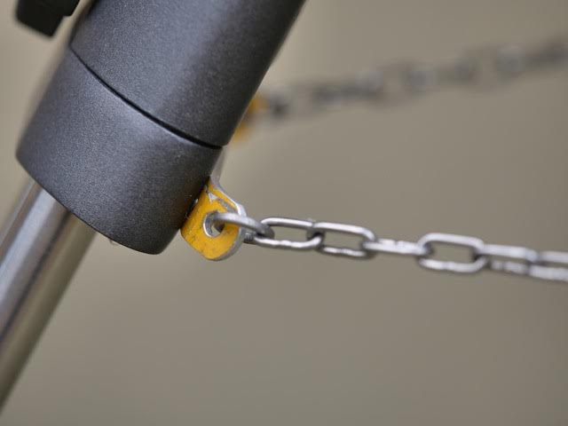

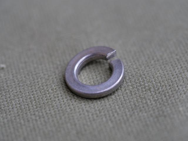

If the aim of the spreader is just to stop the legs spreading accidentally this can be achieved cheaply. I have been using stainless steel chains joined by stainless steel spring washers (see photos). The gap on the washer can be increased by twisting and then twisting back again once the link is inserted.
In one of the tripods shown the chain is attached to the tripod while on the other it is just a loop slipped over the tripod at a convenient point.
Alastair Traill"

Thanks great idea. I might put that to use. I had a similar idea (less sophisticated). I would detach only the one leg that straddles the row from the floor spreader and use gaffers tape to secure it to the floor. The chain would be more secure.
