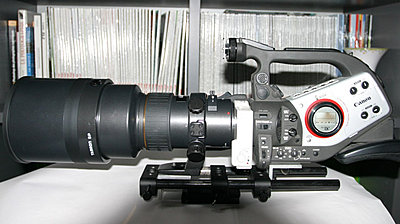

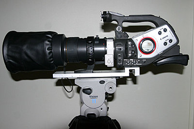

Hi
Here is picture of the system attachement, XL2 to tripod head. The aluminium alloy plate is the more simple and more efficient (right image), i have to modify it to use quick attachement, like Novoflex MC.
The difficulty is to change the lens on the field (arround 20'). Atmosphéric turbulance are a really problem, for the other vibration you must have a heavy tripod with good fluid head and a rigid junction between the head and the video camera. 400 mm seems to be a little bit long, my opinion is that the best, is the 120/300 f2,8 Sigma (a little bit expensive). For the moment i use the 300 mm f 2,8 Tamron the video are crystal clear.
You can see footage on my web site with the 300 mm Tamron, the duck on the page (Ours video Europe) and many others (pics de magellan)
Gilles
Sigma 120-400mm f/4.5-5.6 DG OS HSM on XL2-img_9209.jpg   Sigma 120-400mm f/4.5-5.6 DG OS HSM on XL2-img_9218.jpg
