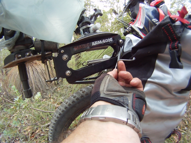

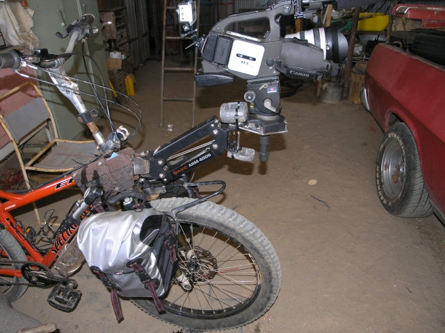

What I did was order a cheap (ish) Steadicam imitation called 'Flycam' Magic Flycam 6000 Steadicam for DVX110A HVX200 HDV XL1 (eBay item 130451143731 end time 13-Nov-10 21:15:49 AEDST) : Cameras from India. I then stripped it down and used the top swing arm. To use this I made up a prototype bracket out of steel and mounted it to the bike. I also made up a prototype mount so I could put the 503 head of my Manfrotto tripod on. This gave me a lot of freedom for pan and tilt. I then mounted my Canon XL2 + remote monitor onto it. To mount the monitor I used a suction cup, [mounted on a piece of aluminum plate I fitted to the Flycam arm] from Gripper 3025 - The Filmtools 6" Suction / Vacuum Cup Camera Mount. I have 4 of these and I hang my 2 Xl2's directly off them on the car, they've never failed yet......(I secure them just in case though!!!!! ) The whole system worked very well, my speeds were exclusive at times and over rough ground but the footage is remarkably smooth. There are issues with the flexible cable breaking but I've come up with a tech fix for that. If you decide to go ahead with this I'm more than happy to go into detail about it. When I get the time I'll have the mounts made from an aluminum alloy. This is a fairly radical fix to your problem and may be out of your budget but if you're able I'd seriously consider it because it gets rid of all the GoPro problems and is well worth it. Incidentally, I had a GoPro piggy backed on the XL2 looking back at me and that worked very well. The GoPro's certainly have a function and place.
Here are 2 pics, the lead divers weights were removed, I tried them to see if it made a difference to the 'float', it didn't. If you look closely on the arm you can see the mounting holes for the monitor plate and suction cup. The second on illustrates the broken cable.
PS. Don't mind the plastic bag over the camera and monitor....I promise it didn't rain too much.... ;)
