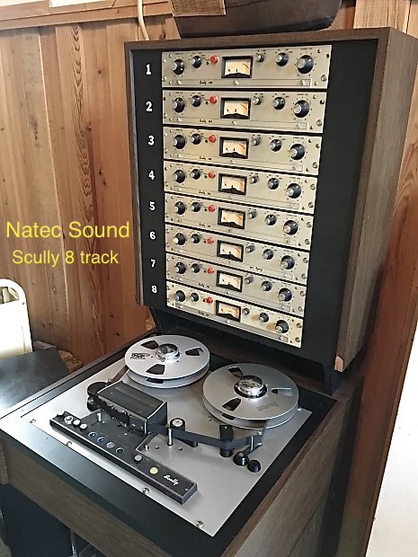

In Sydney years ago before the arrival of the big industrial video screens, I used to produce quadrophonic sound tracks for corporate multi screen 35mm slide programs for IBM and Ford etc. After the narration was recorded and the music track from special discs was complete, specially selected sound effects in the right place could add class to the show.
I remember one show with beach scenes and the sound of the rolling surf in quad really added atmosphere and made it.
For TCN Channel 9, here’s a promotional 5 screen, 8x35mm slide projector rear projection a/v setup, with a video screen in the centre. The quad soundtrack and projector and video player code track was played off this 8 track Scully. All this took 4hrs to set up, run and test for 2 shows daily for an audience of about 500 each show, for a week. Ch.9 also provided a 3 course daily lunch and Moët champagne for each member of their audience of advertising agency people.
At first we used to attend and run the shows but it was exhausting and I had more work to do. So we trained a crew from each client, which came in handy when we had to fly all our gear and play their shows in other capital cities.
