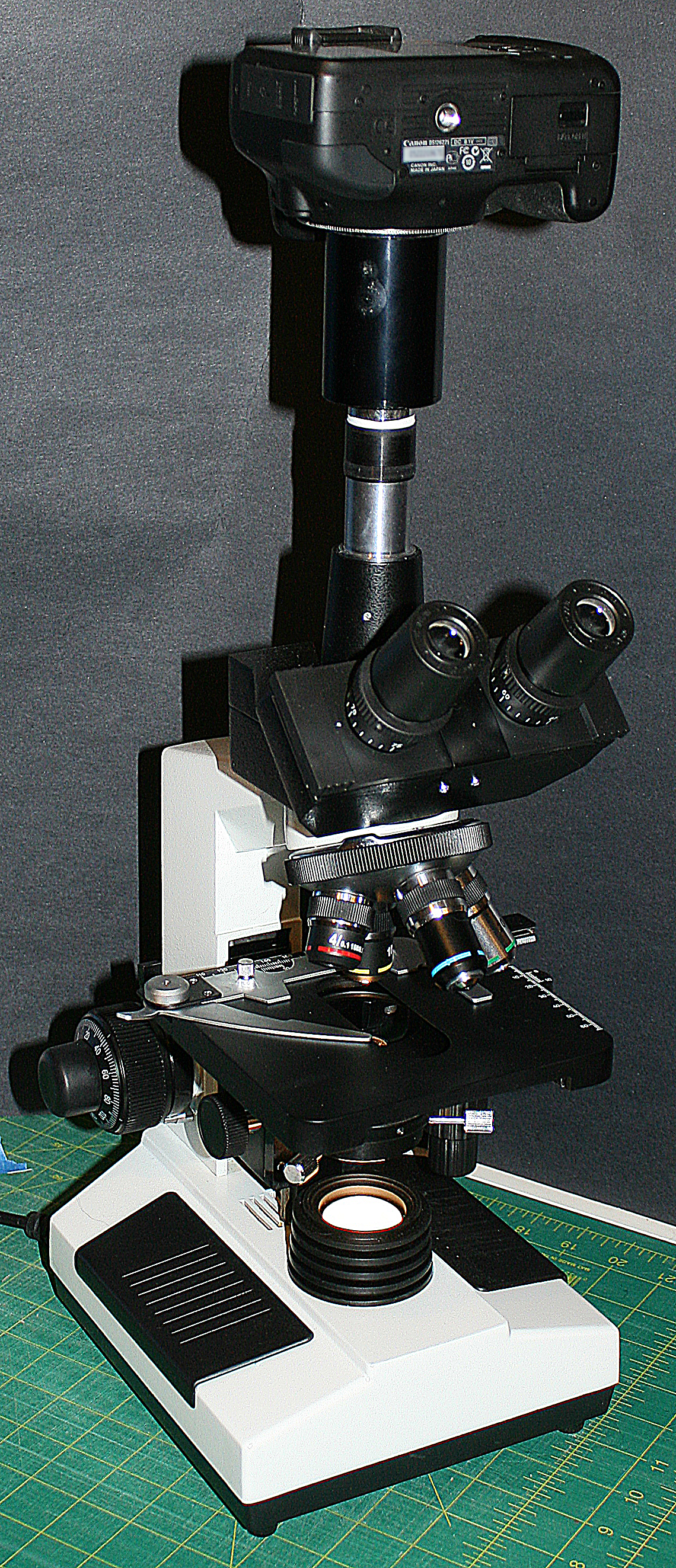

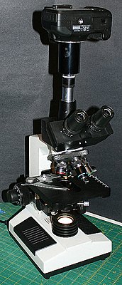

I used to take a lot of photographs through microscopes- not so much for my own research, but because I had acquired the knack, frequently out of “professional courtesy” for “departmental colleagues” in aid of various reports and papers. While I was in graduate school I took several classes in oceanic plankton. A while back I decided that I would like to collect video of many of the strange looking creatures which participate in the planet’s greatest migration (greatest in numbers, greatest in biomass, greatest in frequency…)- the daily migration of plankton to and from the depths. I acquired a microscope (AmScope model #T940B). It is not on a par with the research grade instruments I used to use but is mechanically and, somewhat, optically sound and was within my reduced means. Shortly afterwards UWOL 19 “Motion” was held. I had thought to do a video on the Kingdom Protista, the main division of which is based on the means of locomotion. (Protist ~= protozoa. In this video I used an even older name, animalcules, which was coined in 1683 by Antonie van Leeuwenhoek who discovered protists but did not invent the microscope.) Unfortunately I became ill and wasn’t able to shoot even a single frame for UWOL 19 (and I still haven‘t started on plankton yet either!). When the theme for UWOL 22 was announced I revived and almost completely revised the idea.
The micro clips were shot on a Canon 550D (T2i) coupled to the third axis of the microscope with an EF to M42 adapter and a Meade camera adapter for telescopes. An eyepiece pointer adapter was between the Meade adapter and the microscope. The camera was used at prime focus, with simple projection (akin to using close-up rings), and with eyepiece projection. The projection eyepiece was an 18mm Meade Plössl. Microtechniques used include vital staining, dark field (which trades resolution for contrast) and Rheinberg illumination. Scale was measured with a stage micrometer.

You got a similar setup like I do for Microscope filming... it's fun, is in it!
