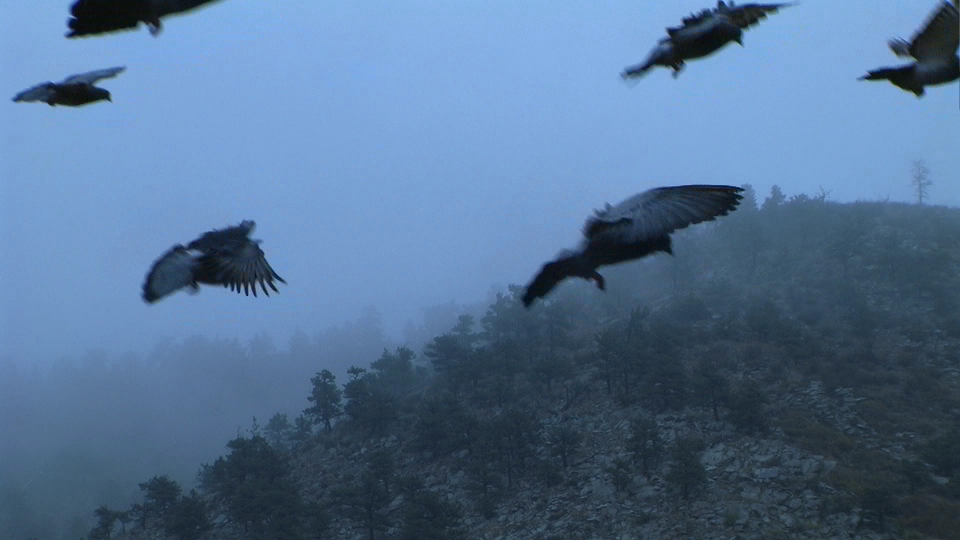

Could be as simple as the editing software is interlacing interlaced footage when it imports giving you a ghost image that's only seen when something moves.

Sadly, the camera, purchased many years ago, has had issues from the start. It doesn't bode well when you have to send it back the day it arrives because the focus was severely out of whack. It has always severely ghosted, pixilated in motion.... the list goes on. The company refused to refund, but I got a memory card out of the bad situation (oh joy!) ;-). Ah well! Making the best of it till I can afford an upgrade. I've used it many years and I have learned a lot on it.

Well, I'll look into this. I'm shooting progressive and strangely the file format it collects in is TOD which must be converted before anything can read it. No matter what I convert to: progressive mov, mp4, avi ... the footage shows ghosting and other problems.
Any ideas? It would be awesome to find a solution and learn that it was post processing all along!
Thanks friend!

I remember reading here in the forum years ago that some editing software, at least back then, converted progressive to interlaced (or was it the other way, I can't remember details).
Maybe something like this is causing the trouble for you?

You should send me some raw footage and let me look at it.
What kind of card does it record to?
If I have some extras laying around I'll send you one to send back with some forage and seen if there's anything you can do.
What do younger to edit the footage?
--==Kevin==--

If it helps, in addition to Kevin, I can have a look at some raw footage too, so we can check out if the different editing suites give different results.
If you use Dropbox, that's an easy way to share footage online.

I'm there! You are both awesome. This would be Christmas come early if you can help me find what I'm doing, if it's not the camera.
I will send you both a short clip to look over. I will look into this more closely myself as well. As it is, it's rare I'm even able to grab a still frame from video footage it looks that bad. The subject must be completely still for me to do that.
Thanks for everything! This being said, I am honestly well overdue for a camera upgrade and need to start doing what it takes to make this a reality. Perhaps all of you in the UWOL community can help me out with some good suggestions for a camera in the $2,000-$2500 range? What do you think?
Look for my email directing you to my problem clip. Yay, help is on the way :)

Well here goes. I looked into my clip problem one more time. When I brought the original TOD file (with the pigeons flying close to the camera) into MPEG Streamclip, the footage of the pigeons ghosted as what I've grown accustomed to. This is why I was thinking it was my camera because the original TOD file didn't look good.
Spurred by your input I forged ahead, changing codecs and changing processing selections. And ... Here you go! Still not the greatest still footage, but no more ghosting.
I can't thank you enough for picking up on this and pushing the issue that it could be a post processing problem and not a camera problem. This is a huge relief and better late than never rooting out the problem and finding a fixable solution. You are the best! And I am very humbled I was ignorant for so long... years!
