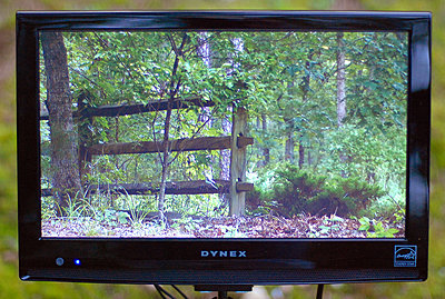

The cashier said "Wow, the 15" Dynex is actually in stock!" This thing looks pretty good to me. It overscans slightly on the component inputs (there's a preference you can set for VGA mode; not sure about HDMI) but not a big deal.
Native resolution is 1368x768 - does a great job for focus with my ex1. After tweaking the picture settings it looks nice.... very respectable next to my 46" Bravia LCD. You can also go into the service menus and have even more control over a number of parameters (press INPUT>2>5>8>0 on the remote).

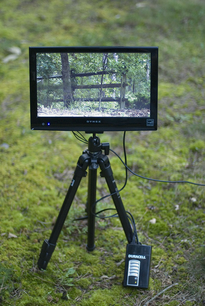

I went out to the woods and played around for a bit this afternoon and used a Duracell powersource mobile 100 to power it. PowerSource Mobile 100 | Portable Battery Charger | Duracell
I had it on for almost an hour with no problems, not sure how long it would run on this battery pack... probably somewhere between one to two hours. These units are made by Xantrax for Duracell and contain a LIon battery with inverter and AC outlet. The Dynex screen is rated at 30 watts.

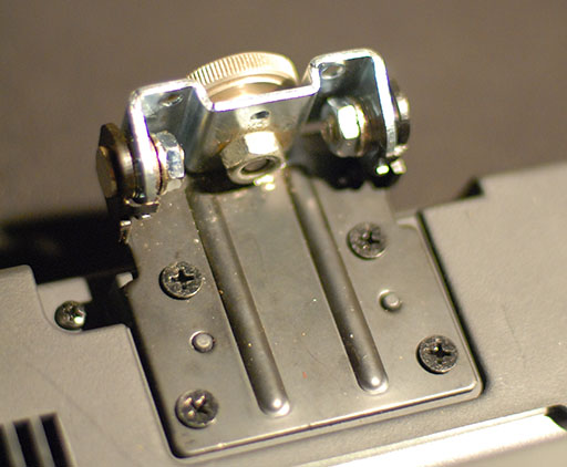

I unscrewed the mounting bracket from the plastic piece which fits into the base, then drilled one of the bolt holes out with a 17/64" bit and mounted on a small tripod I had using a 1/4" nut and washer - see photo below.

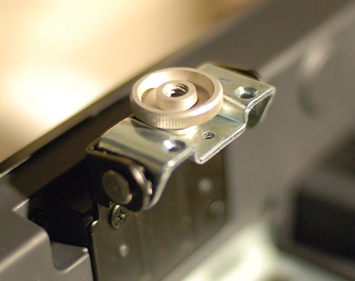

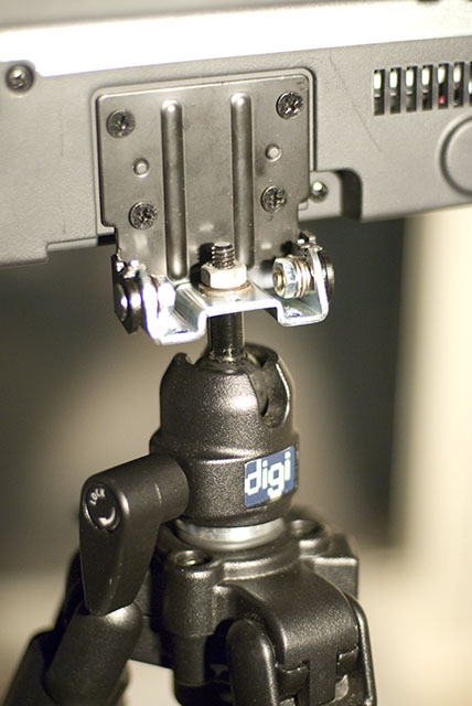

This is a little better - found a threaded adaptor in my trunk of old cameras inherited from my Dad. Of course there are plenty of other ways to do this.
