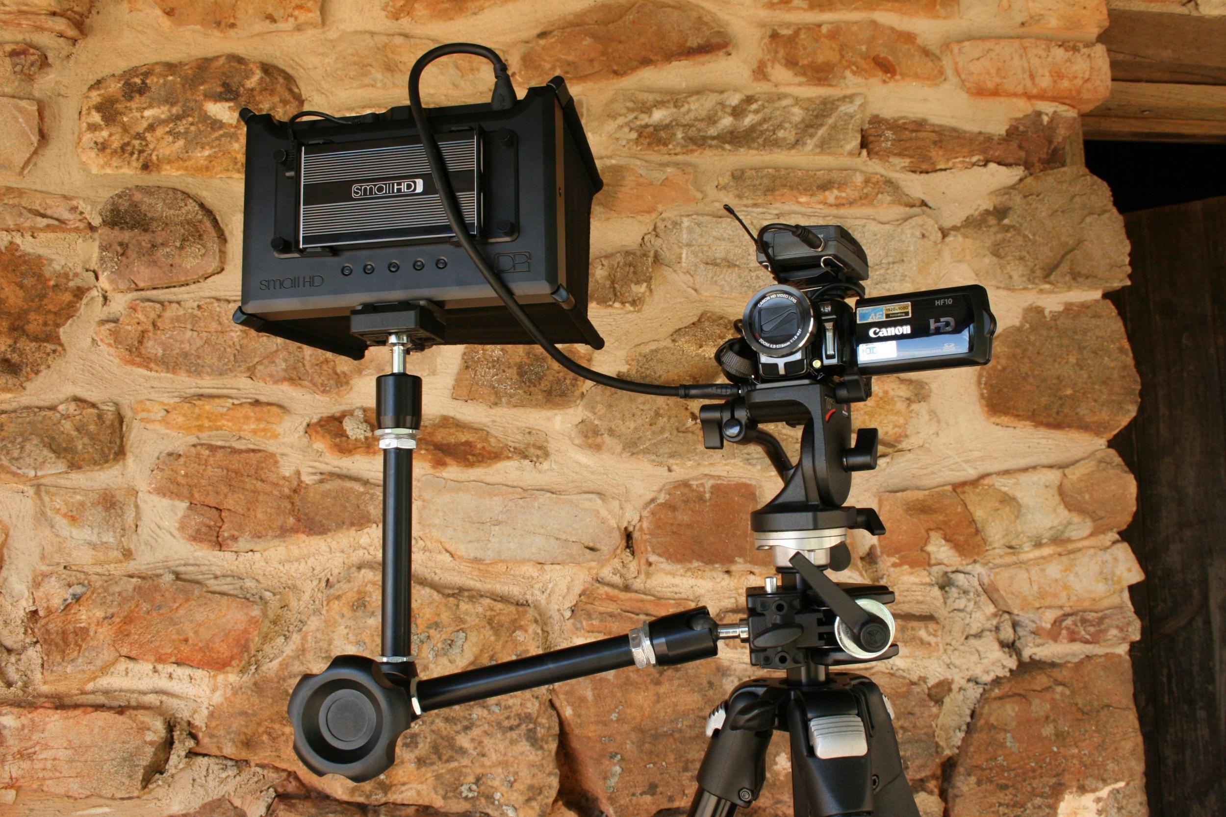

Hi
Had my DP1 for several weeks, very happy. I am using Manfrotto 244 RC Magic Arm to support the monitor, a little overkill, but certainly works. Cheers, Michael.

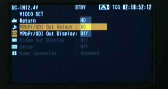

Just got the DP-1
Hello, everyone. Just got the DP-1 for the Sony EX-1. Hooked it up component and it looks okay. Not as vivid as I had hoped. Is there a better way to connect monitor to EX-1 for a better HD picture? I have tried the settings and blew that one so I had to use the factory reset to restore. The tutorials are well done, I guess I just need to follow along more closely. I noticed a jack on the handle of the EX-1 marked, ' HDV ' can this drive the DP-1? Also, I don't seem to be very long battery life from the unit. Maybe a half hour or so on each battery. I am recharging these now to see if by chance they were not fully charged. The LEDs were green on both batteries when I took them off charger.
Phil

575 or 1080?
I'm not sure how to interpret "vivid" in terms of image. Normally that would refer to saturation, but i cant see that being the issue.
Is it possible your EX1 is set to output Standard Def via the component port?
When you fire up the DP1, or turn on the camera, the DP1 should display the type of signal it is being sent. In the corner when the signal comes on, does it say "1080"? I'm not sure about the ex1, but some cams can output either SD or HD via the component, and the SD out wont be very impressive.
if its not a resolution issue, then could you describe what are you seeing a bit more? Is the image unsaturated? Washed out? Too contrasty/Not enough?

Hi Andrew
Thanks for taking time to response. I get a good picture, but it just does not look HD. More like SD. I have the EX-1 set to record at 720 60P. I have not tried any other signal. I think you may be on the right trail relative to an output setting from the camera. Where might I check that setting and what should it be set for?

In the monitor options on the ex1, check that ypbpr is set to HD.
http://www.dvinfo.net/forum/images/attach/jpg.gif
if that doesn't fix it, let us know and we'll see what else might be up. I have more experience with the ex3 than ex1, but the image should be similar. Monitoring the ex3 on my DP1 is stunning. Sometimes looks like you could reach through the screen.

Yes it is set to HD
I checked and have that set to HD and even changed the format to 1080P to see if that helps. Some of the screen shots I see here from you guys using this monitor is what I am hoping to get and mine just does not look that good. Possibly some numbers as to what the settings should be might help.
Phil
