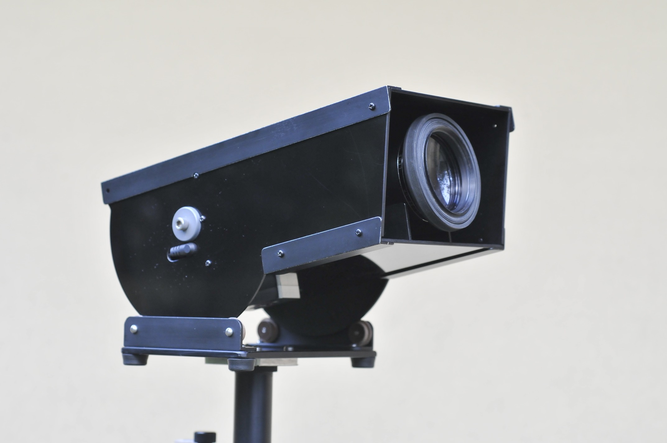

I have mounted my DP6 in a rigid hood that acts as mount and battery holder etc. If I want to see the image in more detail I can slide a lens assembly into the viewing port. The lenses are photographic close- up lenses, a +4 and a +2 giving a total of 6 diopters or a focal length of between 6 and 7”. http://www.dvinfo.net/forum/images/attach/jpg.gif
Hood / Loupe for SmallHD DP6-_dsc8518.jpg
