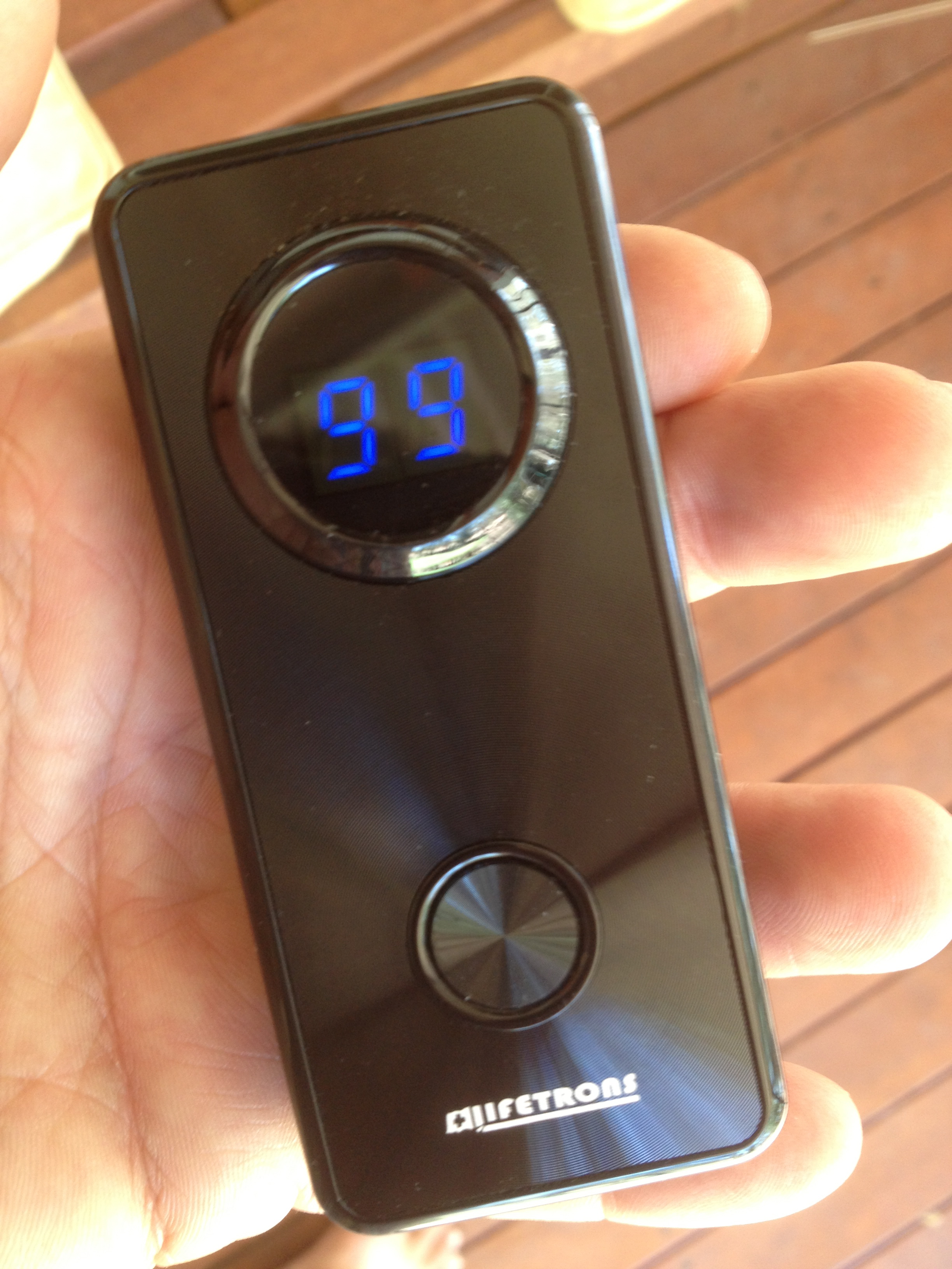

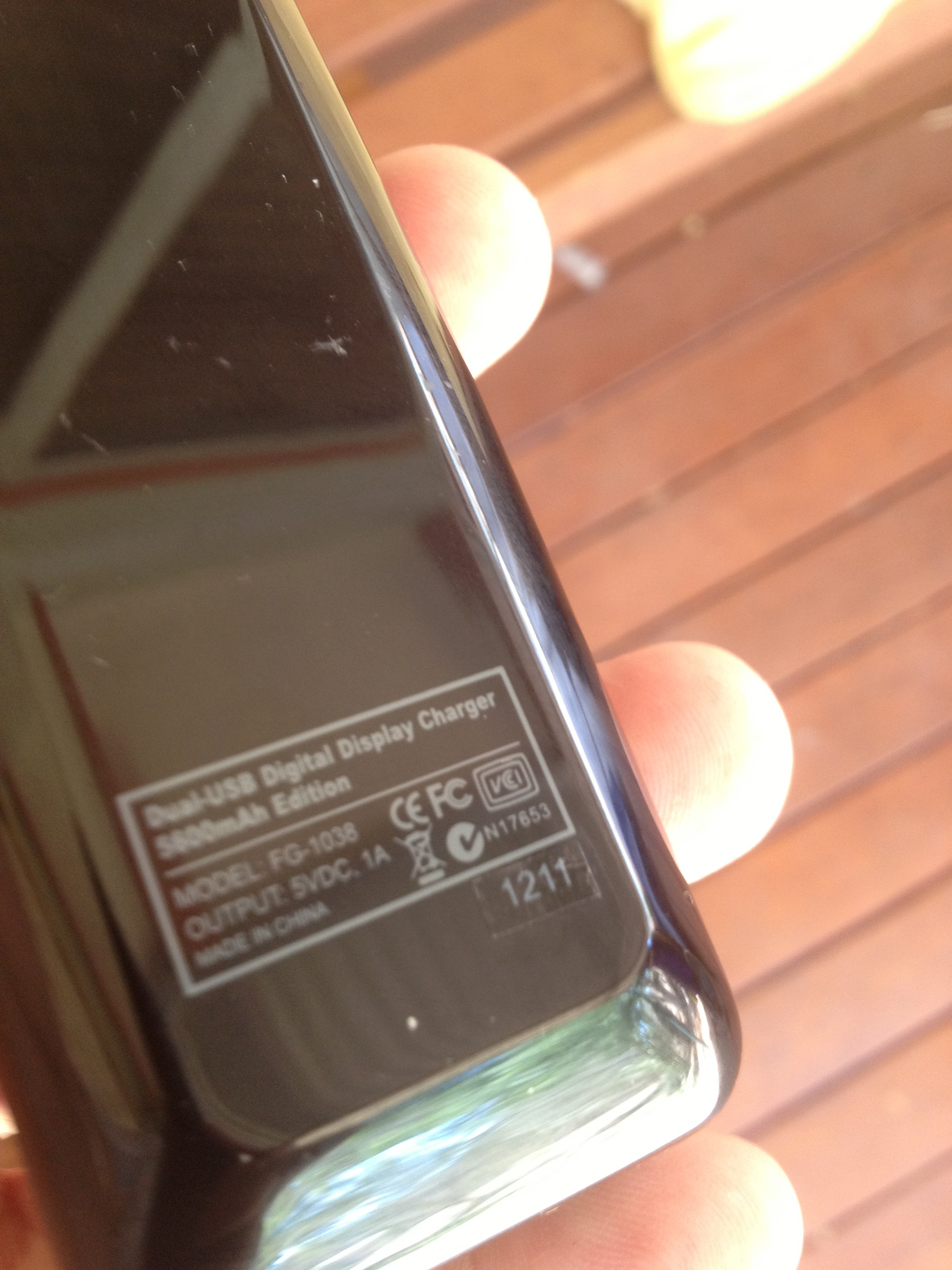

Another alternative might be this lifetrons power pack (see photos) which I actually bought to remotely charge my "i-things". The HDMI monitor is already independently powered so I suppose I could just use one of these at both the TX and RX ends for HDMI transfer, would that work? I guess I would then just use normal USB cables as the lifetrons has both USB and mini-USB in/outs on either end of the unit. Is 1amp enough to make each end of the HDMI system work?

Those batteries work great for the mini HDMI transmitters.

the device require too many power , more than you can get from an usual USB port (usually max 1A)
Some USB can give more especially if they are not on a computer, so you need to give a try.
Most of device providing 5V on a USB socket are specifying hom much you can load it.

i got 3 power bank like this one and they are ok (but the USB output is limited to 2A, and there is only one, so it could be a limitation).
from my experience , the emitter ask for 1A and you really need to provide this current because i tested several cheap chinese adapter providing 5V 1A, and it was not working.
