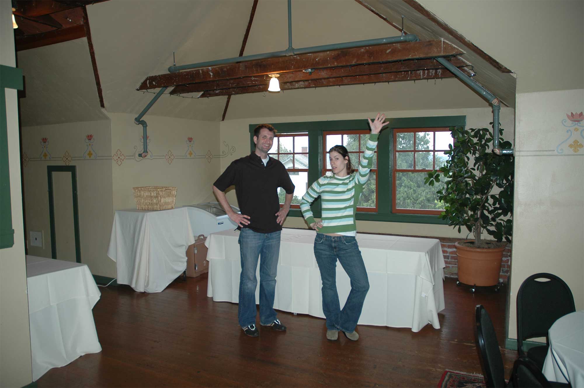

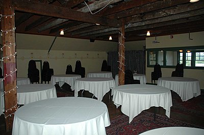

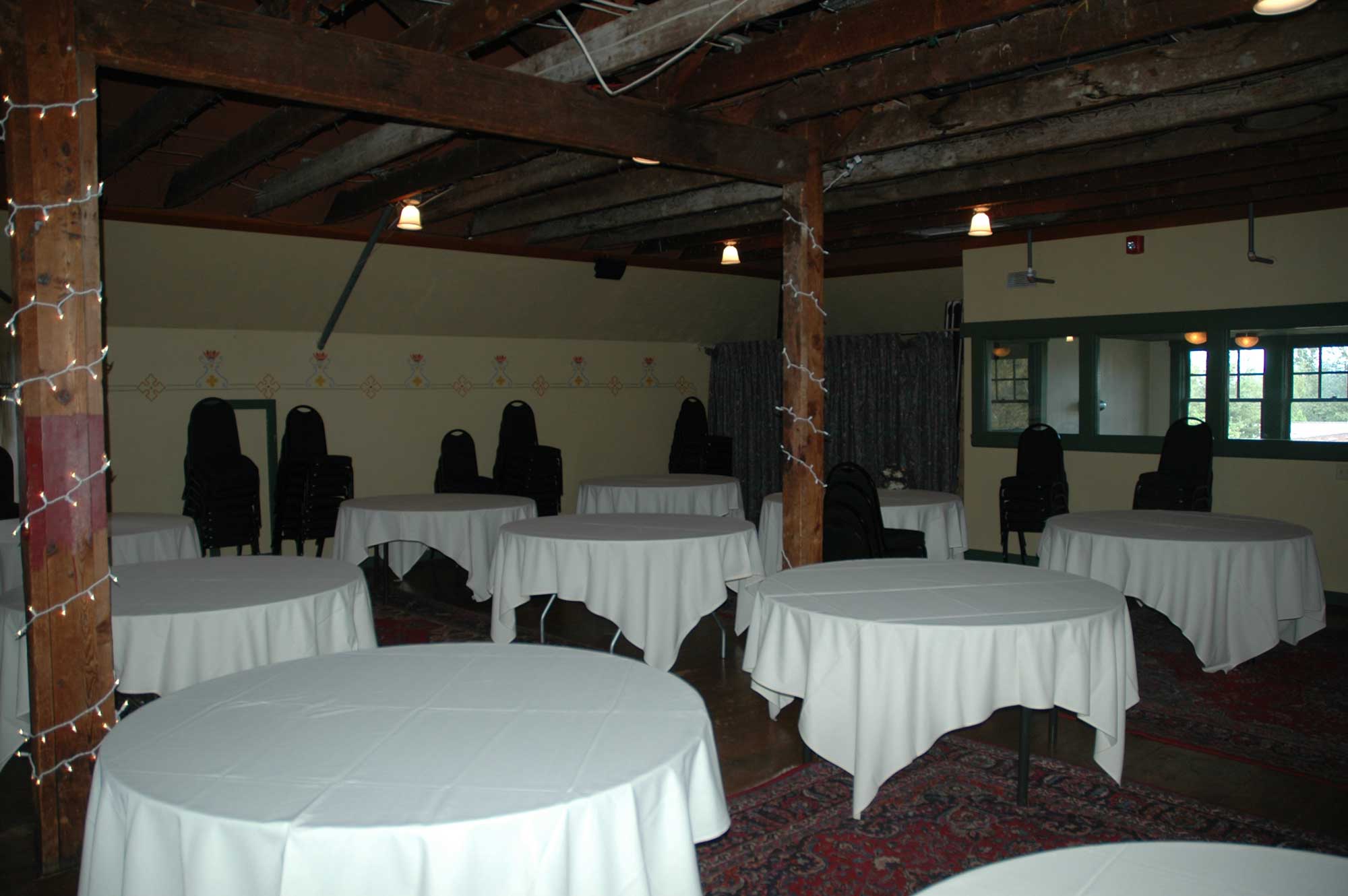

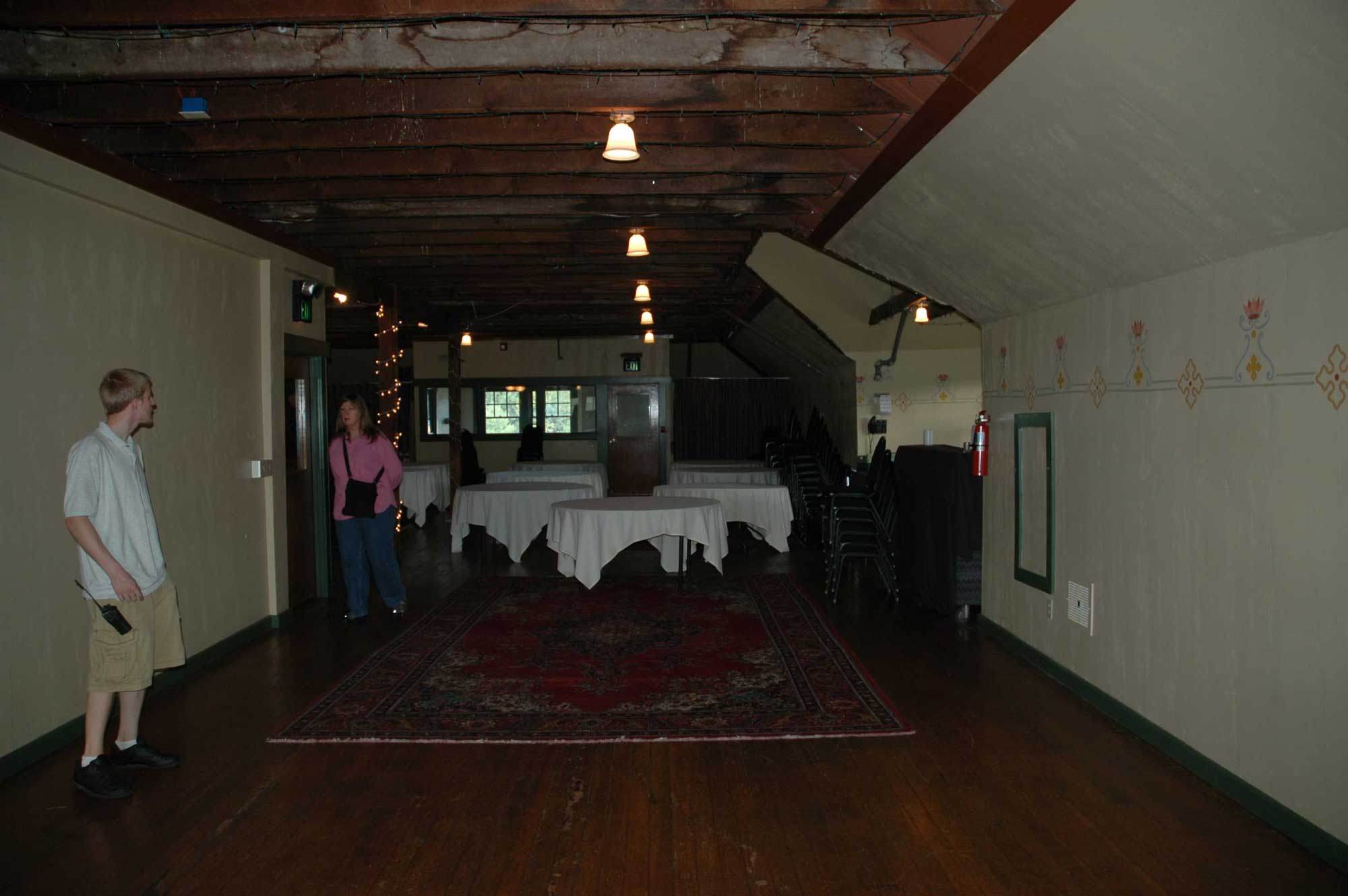

I have a wedding coming up in a week or so, and am trying to figure out how I am going to have enough light. (I am using XH-A1's)
The Ceremony and Reception take place in a room called The Attic which is very dim and we will have to depend on interior lighting since the few windows will be blacked out. The only lighting there is are ceiling Xmas lights and a few dim incandescents.
We can bring in an extension cord and probably have the room to put up 1 light. Any suggestions? Here a few pics. The Bride and Groom are standing where they will be(there will also be groomsmen and maids). Note that it will be darker since the pic was taken in the summer, with a flash, with the windows open.
Somebody suggested a flood light. I have done so many weddings, but never brought any kind of light, since I prefer not to use them. Since this is so dark, I am making an exception.

Perhaps bounce a 500W off the ceiling from the ceiling beams? Bounced light won't blind the guests and may give you an extra stop or so of soft light. For the area where the round tables are, maybe you can ask the venue if they'll let you swap out the light bulbs with something more powerful. Although that's a stealth solution, it might be too much hassle. Have on-cam lights ready to go! Good luck with the wedding.

In this particular situation some kind of room light could be helpful, even if it's just a standard lamp positioned in a corner.

Ditto lots of good advise above. If the B&G wanted several hours of video at the location, I'd probably put a few Lowell 800 watt Totas on C-stands and bounce the light off the white sheet rock (not the dark wood). And for the dark wood, I'd aim several Lowell 500 watt Omni up and bounce them off silver umbrellas.
But if you don't have this type of gear or it's short or spuratic shooting, then by all means use a 40+ watt on-camera - or better yet, hand-held if you have an assistant (remember, key light first towards subject, then camera on dark side of face, then fill light or reflector). For my XL-2, the Varizoom LED puts out up to 40 watts (uses Canon batteries) but for serious work to avoid grainy pix or long distance work something like the NRG 100 watt light is more of a workhorse - as was mentioned, just be sure to use diffusion, dimmer, or softbox so you don't make enemies.
