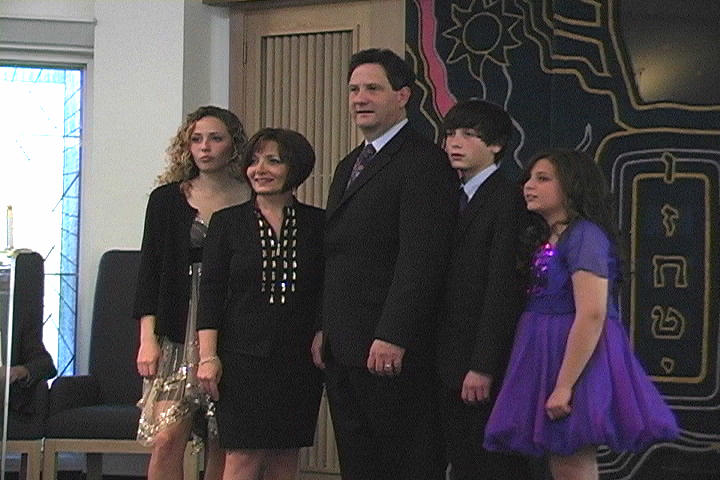

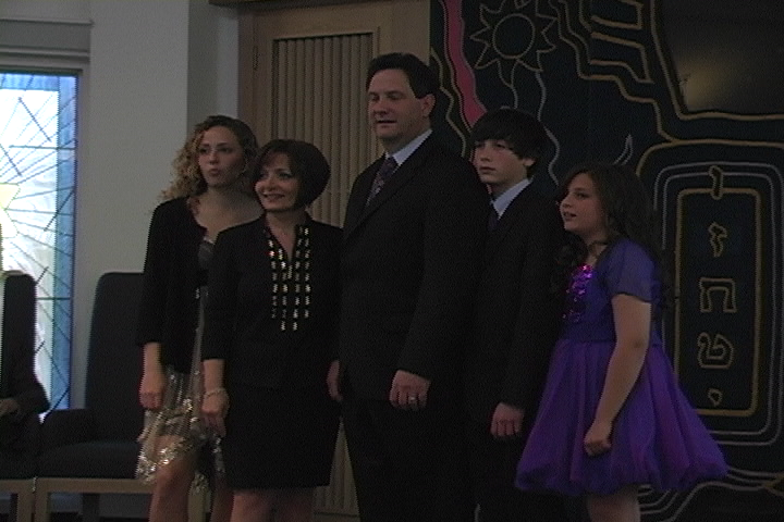

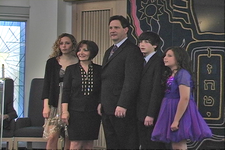

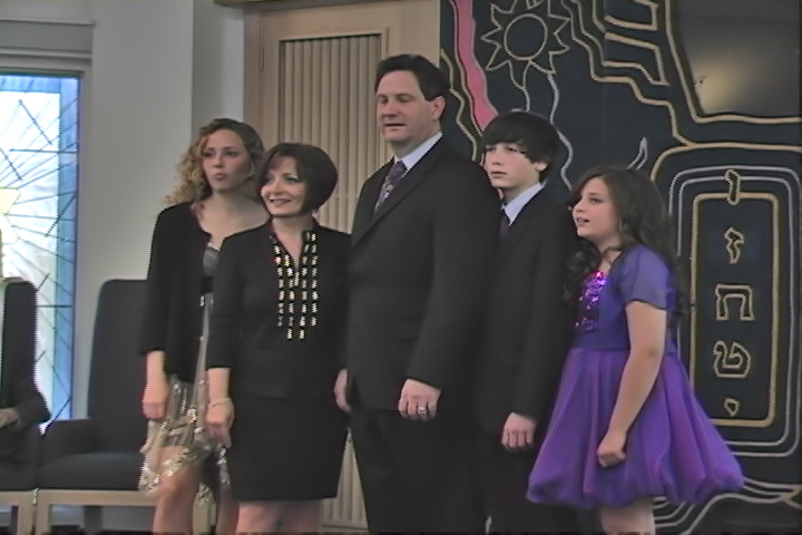

Alright Brandon heres some pics for you. Pic 1 is the original. Pic. 2 is brightened with shadow/highlights Pic 3 is pic 2 with neatvideo. Pic 4 is the original brightened with your method, levels rgb white from 255 to 150 black from 0 to 5. Pic 5 is pic 4 with neatvideo added.

Thanks, Adam!
The neatvideo plugin definitely yields cleaner results. A softer image, but much preferable to the grain.

You really need to play with it and find good settings, sometimes it makes the picture way too soft, but finding the minimal amount that cleans the picture up seems to work best for me.
