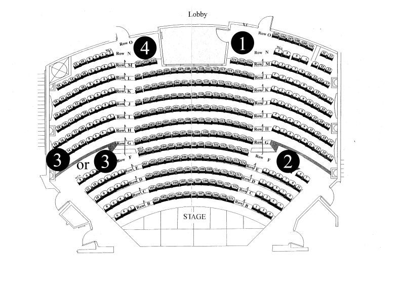

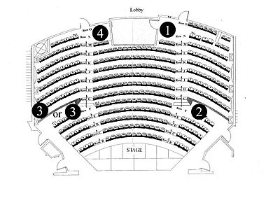

Below is how we place our cams in our theatre. Note that if we have the same framing on cams 1 and 4, it would be virtually the same shot, so 1 is always very wide and 4 is always medium or close. But 2 and 3 can be zoomed/framed similarly since their placements are so different. 1 is our IdiotCam(tm) and it is the one I operate for safety. It is always locked full wide, full stage. If everything else is screwed up -- and it sometimes is -- we always have this. Unless I have screwed up. And I have.

I do not necessarily disagree with Adam and Dave, but my thinking on two widely spaced cameras with different angles of view is that: (a) this will be Brad's first try at this, so it is important to try to keep this simple enough to work reasonably well; (b) placing cameras on opposite sides of the room (if he can do that) with, better yet, one camera high to one side in the balcony and the other low and sort of centered, is the easiest way for him to get differing views; and (c) Brad will probably be framing more tightly with the cam he has than the wide view of the other camera, so there will be differences in view almost as a matter of course.
In Adam's drawing, with the positioning of cameras ## 1 and 4, I think that there is enough space between them that you would not get the sense of a jump zoom when cutting between them provided you have one camera always framed tighter than the other. The difficulty I see for Brad is that he may not always be able to do that.
Adam and Dave are quite correct that a significant framing difference can work for having the cameras next to each other. As long as the framing difference is large enough, you avoid the "jump" effect when cutting between the two views. Personally, however, I had to learn a sense of the difference from experience and still do not always get it right. Since I also work with at least four cameras, I have at least two other very different views to fall back on when (as happens) I do not get the framing difference large enough. Brad does not yet have this experience and is working with only two cameras. My thinking is that "doubling up" from the same location could make the experience more stressful than it needs to be.
