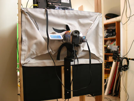

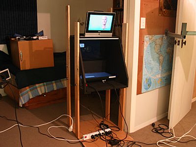

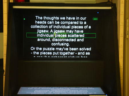

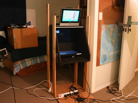

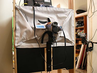

The thinnest window glass you can get is necessary, otherwise you get a double image...one from each face of the glass...I know! With thin glass the double image is hardly detectable.
Also...I moved away from using my laptop to using an LCD computer screen as the laptop fan would come on 20 secs out of every minute and it it was only about 1.5m from the microphones! No point going to all this trouble to have fan noise in your audio! I still run it from my laptop but proprompter pro can run two screens, so I put the laptop into a sound deadened box further away, and control it via a wireless mouse. As I don't use the laptop anymore, the hinged flap shown on the plan is also redundant.
I've attached a pic of the plans I made it to, only I've changed the legs to vertical and cut slots for the leg screws rather than holes, so that the box can more easily be raised or lowered... and have locked the bottom of the legs on a sheet of mdf so it can be easily slid around on the carpet of my studio.
Clearly the teleprompter is not easily portable!!
