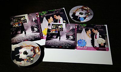

I'm in the US so using Letter size photo paper. What I did is to move the design to the top left of the edge. Then using the Epson printer borderless printing feature, I only need to trim the bottom and right of the page. Works well.
Take a look here and you can download my DVD and BluRay Template too.
DVD and BluRay Design Template | L.A. Color Pros Blog

I also stacked the photopaper and trim them with xacto knife on cutting matt. Cut 10 to 20 sheets at a time. save a lot of effort too :)
