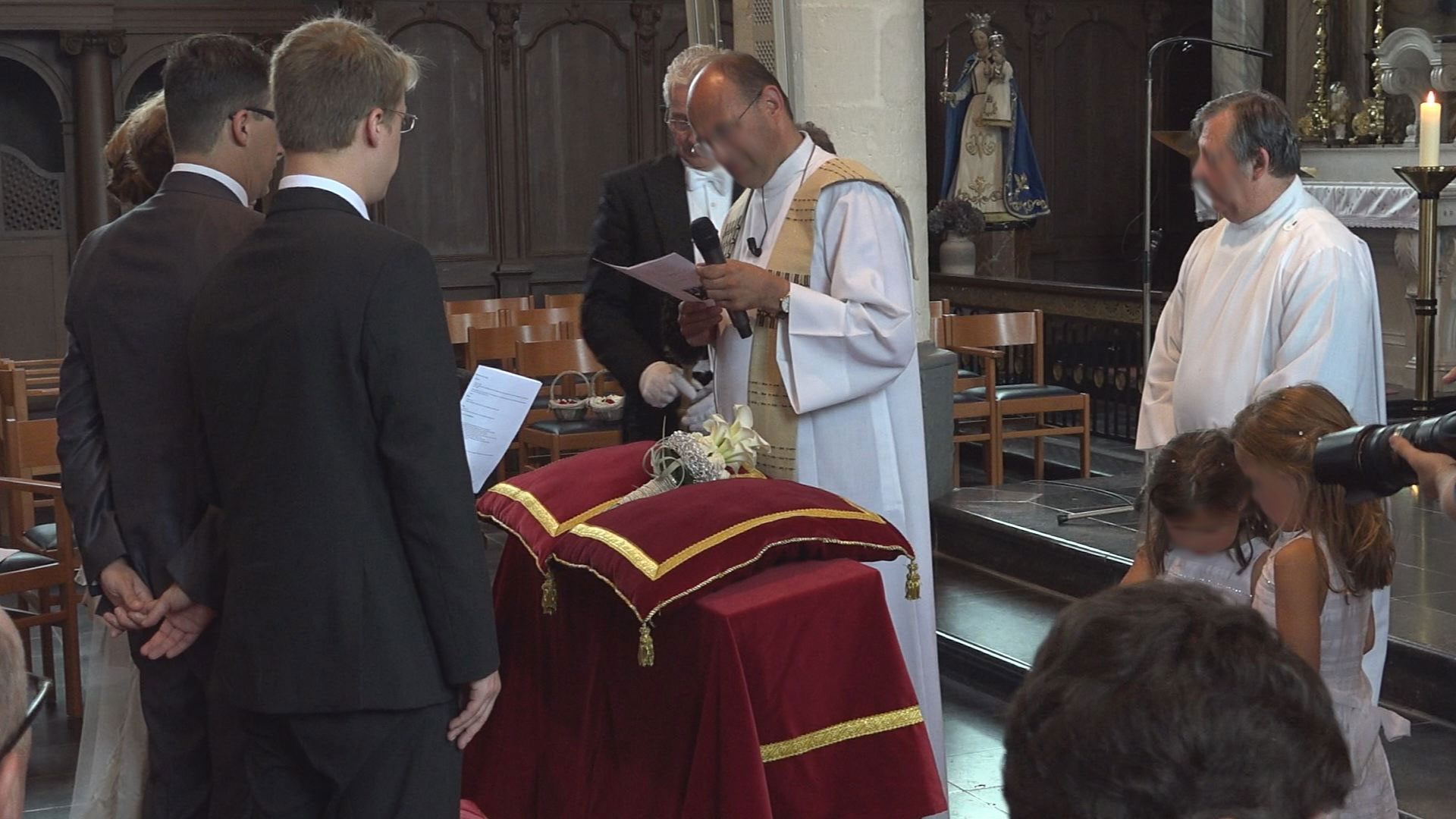

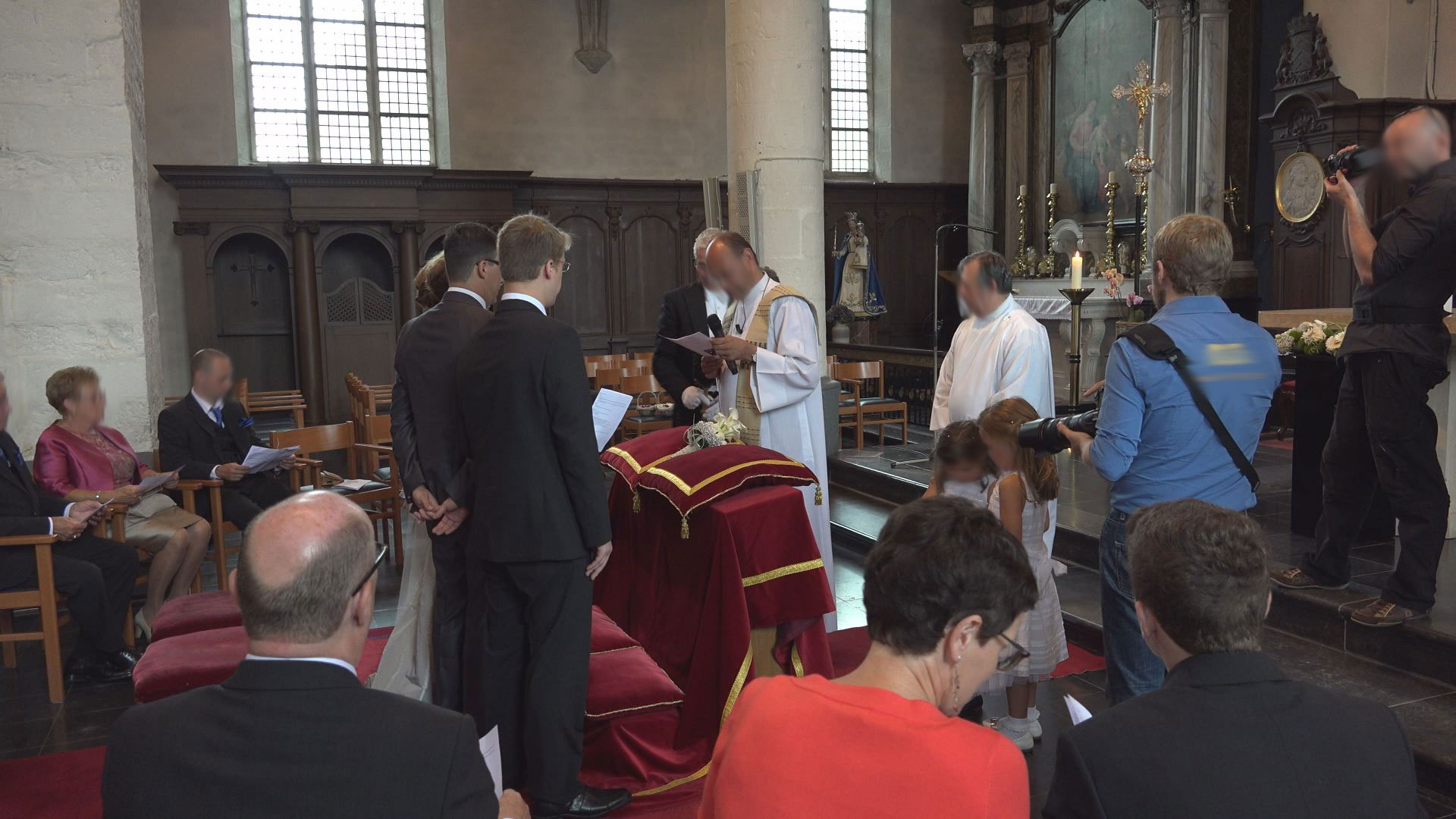

Last wedding I was shooting the ceremony with my ax100 and a cx730, when the vows started I quickly pointed my ax100, which was on a tripod, towards the position where the couple and priest would be standing, because I was not exactly sure where they would be positioned I just left the lens wide and see what I could do in post afterwards.
In below frames you see a before and after cropping in post, before shows me and the photog in the image and the second the 4k image cropped on the 1080p timeline, the 4k image is now shown at it's full resolution and eventhough I could even zoom in further image degradation would start to show from this point.
So now I can safely take out any unwanted parts from the frame and mix it without any issue with my other camera, the cx730. This is THE reason why I wanted 4k. in my case, especially during ceremonies when shooting solo it makes all the difference and allows me to provide a higher quality product, it ofcourse can't remove a photog if they will stand in front of the camera :) but it will dramatically improve framing mistakes.
(Don't pixelpeep the image, it's a lower quality export from photoshop after I blurred all faces as I don't have permission to show this online)

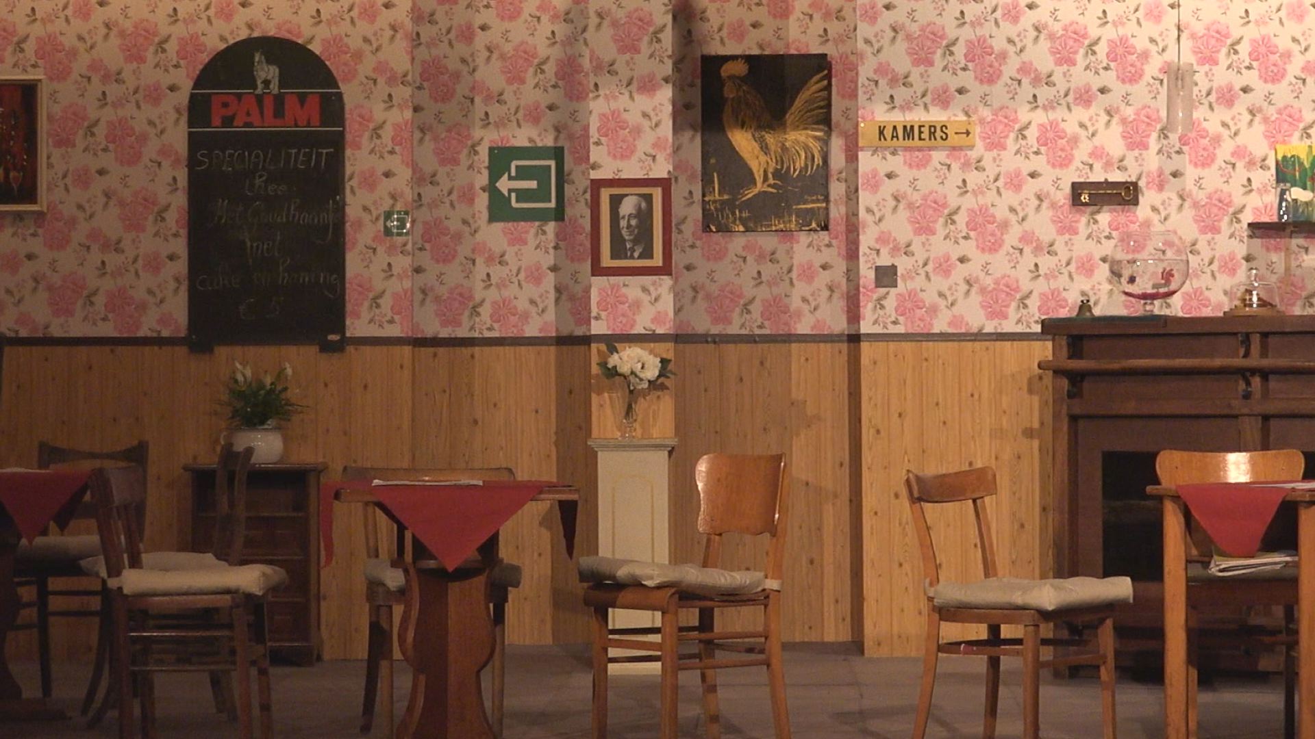

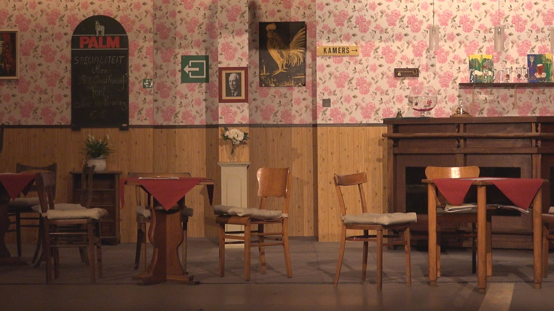

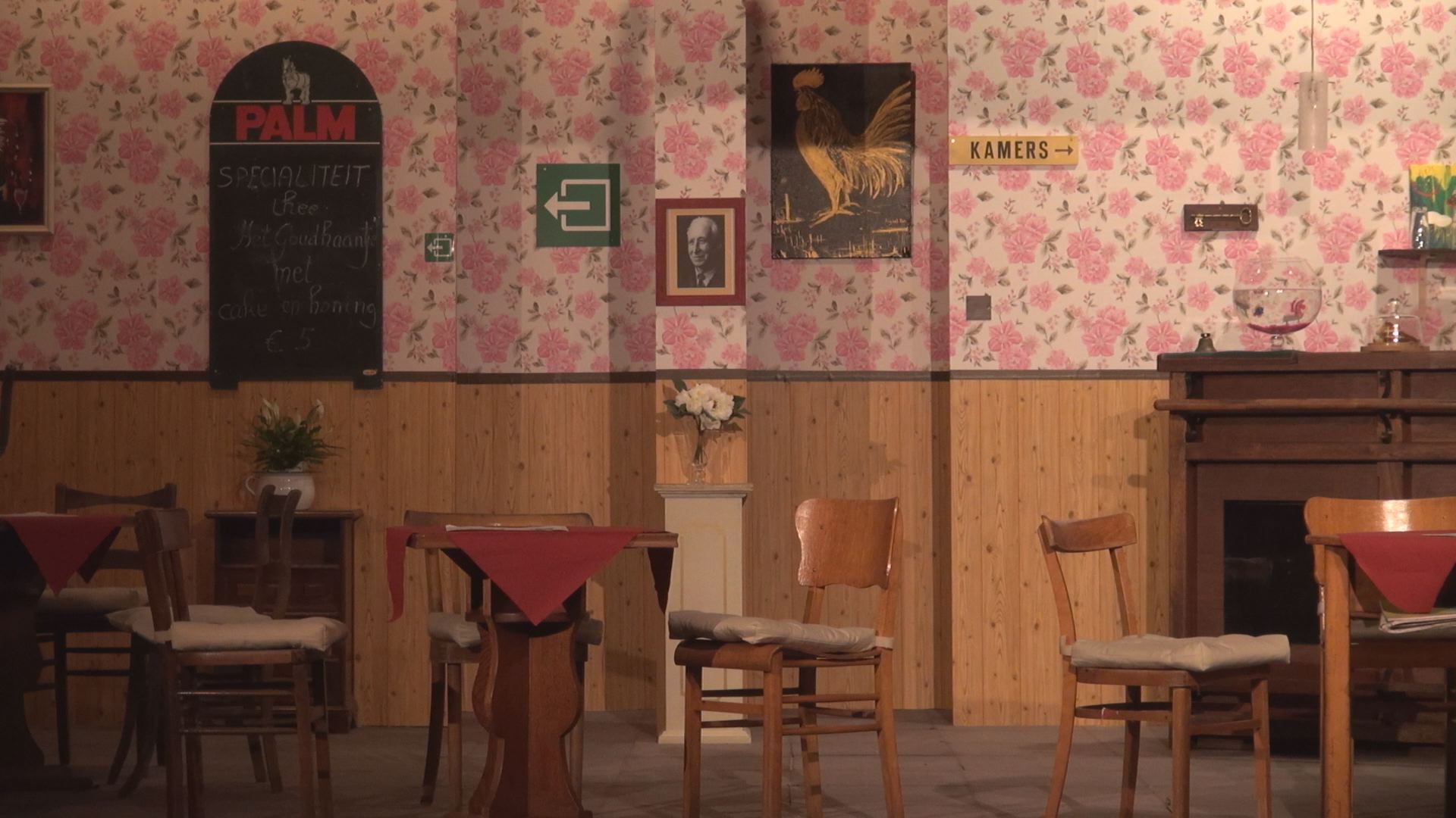

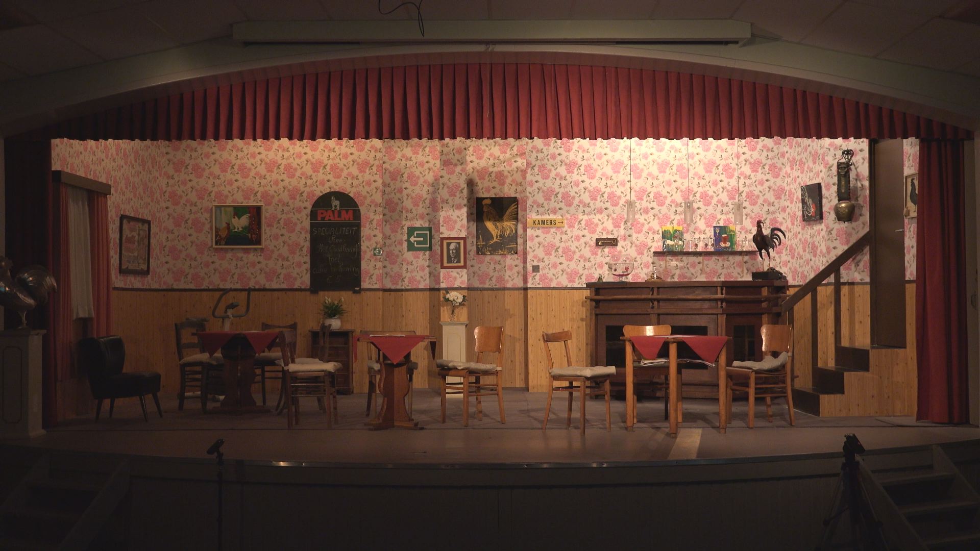

I"m editing a stage performance that was shot on the ax100 in 4K which was set wide and a cx730 was used to zoom in and follow the action, if I really wanted I could have locked the focus on the ax100, set the exposure to auto (light was constant on stage), then have a cup of coffee and enjoyed the play without looking at the camera and do all my cropping and reframing in post.
The footage from my ax100 cropped looks almost identical to the cx730 footage zoomed in, from a normal viewing distance you can't see the difference, only if you export the frames and compare in photoshop you can see the cropped 4k footage is more coarse in fine detail.
I thought I just mention it as this can be another advantage of shooting in 4K and editing in 1080p.

I can't show anything with the actors inside but I have a view of both camera's on the empty stage, the camera where from the same distance from the stage.
This is the first framegrab from the ax100 how it was set wide as a locked off safetyshot: (this is already downsized to 1080p, so it's not the native 4K resolution.)

This is a crop up to the native resolution of the ax100: (in a 1080p project)

and this is zoomed in by the camera from my cx730:

and one last, here I cropped the ax100 footage even more to match the frame from my cx730, so at this stage image deterioration is starting to appear because I"m going past the native 4K resolution but it is still usable:
