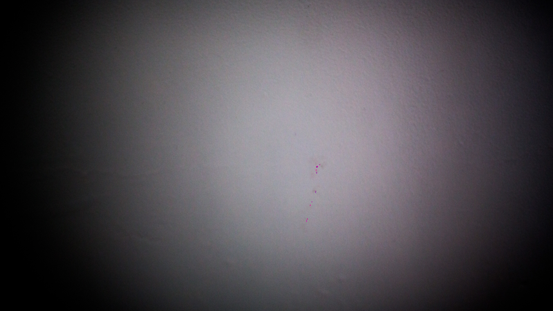

So, one of my cameras is showing a line of coloured dots towards the centre of frame. Attached is a photograph of a wall, with contrast turned up to make the problem obvious. The pattern is clearer on some backgrounds than others, and the dots sometimes turn black instead of red/pink when they're against dark backgrounds.
Has anyone seen this sort of pattern? If so, what's your diagnosis? Dead pixels? Hot pixels? Or damage to one of the filters instead of the sensor itself?
Going to visit a repair shop tomorrow. Fingers crossed that (a) they can fix it; (b) it will actually cost me less than the price of a new camera body to fix it...

Disco laser light damage I reckon.

Laser light damage by the looks of it.
I've faced my FS700 straight in to halogen disco lights without issues. But only recently discovered LASERS can damage the sensor. Thank god I haven't voluntarily faced lasers yet.

Yep. one of the EA-50 guys had exactly the same issues and it was laser damage from the DJ's rig.
Bet it will be a new sensor at the least! I had a wedding a few weeks ago with lasers so I positioned myself right beside the unit and made sure that the beam couldn't get my camera. You also have to be careful with any other reflectors in the room too (mine had mirrors so I had to be extra careful.
Was that the 5D Adrian??? Canon repairs are not exactly cheap ..maybe invest in a new body and stick that one on eBay saying "needs repair" if the sensor cost is really high ..it's amazing what people will pay for cameras that need repair on eBay
I guess an insurance claim is not covered on your policy???

Just for interest's sake, the repair shop are examining it now. If it's a clean, it's $70. If sensir replacement, $1500.

Well, I did get a second quote for $1,900 (the earlier one was $1,427). Neither of these were from Canon. It was also mentioned that, if I sent the camera to Canon, they might be able to do "pixel compensation repair", whatever that is.
I've asked for other quotes. Will edit and update this post if they come in.
(Update: Three other stores declined to quote without seeing the camera first. Another store said, "Show us the camera. $50 for the quote regardless of whether you go ahead with the repair or not. All seems a bit dodgy to me -- I feel the frustration brides sometimes feel, "Can't you just tell me your prices straight?" But anyway...)
