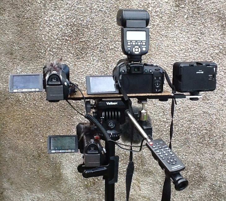

In response to Dave's frantic pleading, I quickly set up the tripod and baseplate with some cams and bits and took some pics with the iPad.
A few more bits than I would usually hang on it, but shows the possibilities. From front left to right top
132 led dimmable light
Panasonic Lumix FZ200 with Speedlite (Could be my Canon Dslr instead)
Panasonic SD750 3cmos with mini wind damper on mic and controlled by remote on panhandle.
Mic with Rycote wind damper connected to SD750
Panasonic SD750 on clamp on tripod central column.
For shooting in 3d, I can use a pair of the 750s or FZ200s using a twin wired remote on the 750s and wireless triggers on the FZ200s.
For weddings I would have the 3 cameras for a cramped ceremony, but use the clamp for a wider angle if space permits and the GoPro for another angle. I wouldn't need the light and mic during the ceremony as I use portables. For school productions, 3 cameras on the tripod with two locked and Claire, my wife operating the fourth and probably the GoPro at stage front. All but the GoPro monitored through a vision mixer with large multi view monitor so we can see what each camera is doing on all stage production shoots.
The Panasonic 700/750s are due to be retired before next season, although they have been so reliable and such good quality, that I am a bit reluctant to change something that works so well. I may look at the 920s as they could all be controlled and monitored by wifi and they have a slightly bigger sensor so should be even better in low light. As I am also intending to get a Panasonic FZ1000, I will probably wait to see how that performs before making my mind up on the others.
Roger

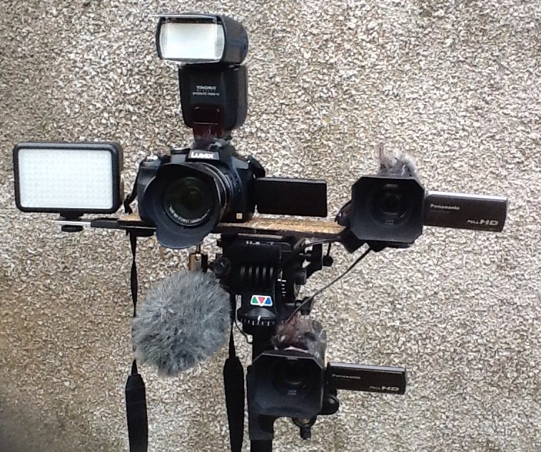

Only seem to be able to load 1 pic per post, so here is one from the other side.
Roger

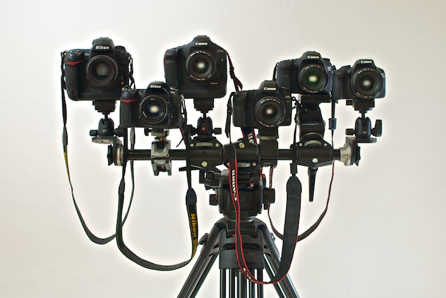

For simply mounting two cameras, or three or four, why not just buy this: Manfrotto 131DDB Tripod Accessory Arm for Four Heads 131DDB B&H
Each camera gets it's own head if desired, and can be moved independently of each other.

I'll have to post pix of my "hydra" setup, but it looks rather related to Rodgers set up... although with 4K, it's suddenly become a bit redundant. Last shoot I pulled the extra bits and just mounted the AX100 on a single head, then transferred to a Sirui monopod for the rest of the day - very freeing.

Looks like a useful mount, but all the cameras on it appear to be on ball joints, which makes them individually adjustable but with no smooth pan and tilt that would come from a fluid head. For weddings, the main cam has to have full motion to constantly follow the shot, which is why I prefer to clamp the fixed wide cam on the non moving central shaft. The only other cam on the main plate, will follow the action along with the main cam, for stills or an alternative framing of what the main camera is seeing.
Dave, my thinking for the new year is very much like yours, with a 4k cam to crop the alternative shots from.

Hey Roger, the picture Jeff posted is the accessory that I use. Re the heads, you supply your own; it doesn't come with them. So, you're quite able to use a head that gives better panning ability.
Doesn't mean this setup is without its downsides of course -- yours is much more nimble. On the other hand, the Manfrotto setup might be able to cope with greater camera weight (but would also require a chunky tripod).
