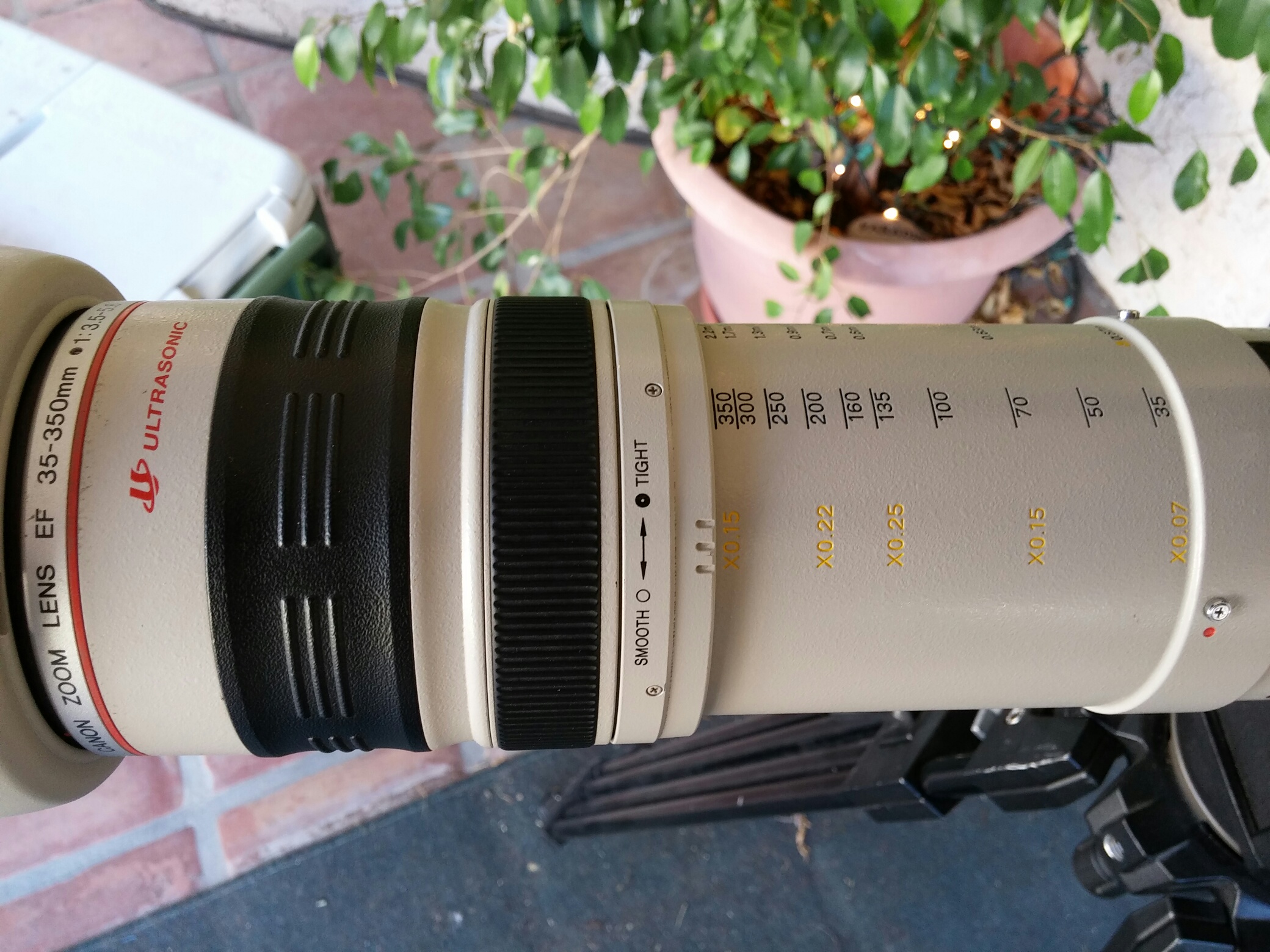

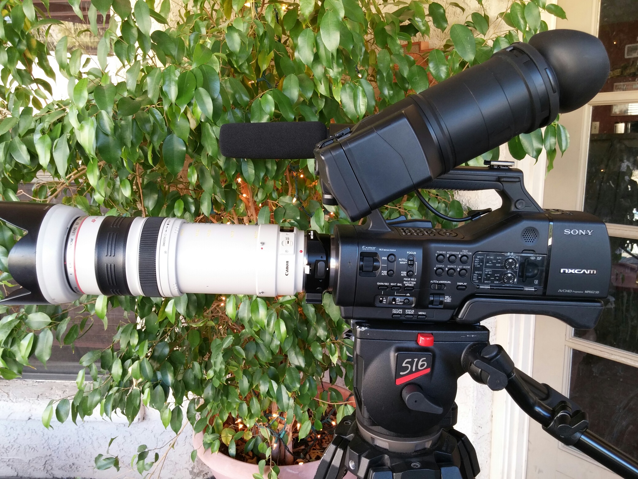

Hey Guys,
Since you are discussing Canon lens options I thought I would throw some info to you on a little known Canon lens. In the early nineties when I was a full time sports photographer I converted from Nikon to Canon. This was the first lens I bought. I thought it would be good until I replaced all that focal range with their f2.8 zooms. I did and It was good. In fact it was so good it continued be a work horse to this day.
It is the Canon 35mm-350mm L F3.5- F5.6 USM Super Telephoto Zoom Lens. I would never recommend a super telephoto zoom lens unless it is this one. You can’t make an extreme lens like this unless you put money and quality into the manufacturing. All of the cheep one have problems someplace. This lens is tack sharp at all apertures and all focal lengths. The good news is it is discontinued and not expensive anymore. I think I paid close to $2,000.00 for it back then, now I see them on e-bay everywhere from $600.00 to $1,000.00. For six or seven hundred bucks it would be a great addition to add to your quiver just for its extreme capabilities when you need it. I know it is too slow to be a good wedding lens. These days I use it on my EA50 when I am in the back of a ballroom and I have to shoot a guy on the stage, head and shoulders tight for the I-mag screens. If you have a need for a long reaching lens this could be it and you can zoom all the way from 35mm to 350mm. That is pretty cool.
For video it is obviously a tripod only lens. With that said I am comfortable using it without rails. If you are a DSLR guy you would be using the lens collar it comes with and suspending the body if you do not have rails.
This is heavy, clunky, monster of a lens. You are not going to get a smooth live zoom out of it. However, once you pick your focal length there is a smooth/tight ring on it that can lock the zoom if you want to.
This thing is “L” series sharp and I love having it when I need it. If you can find one in good condition on e-bay it might be worth considering if you have a need for something this extreme.

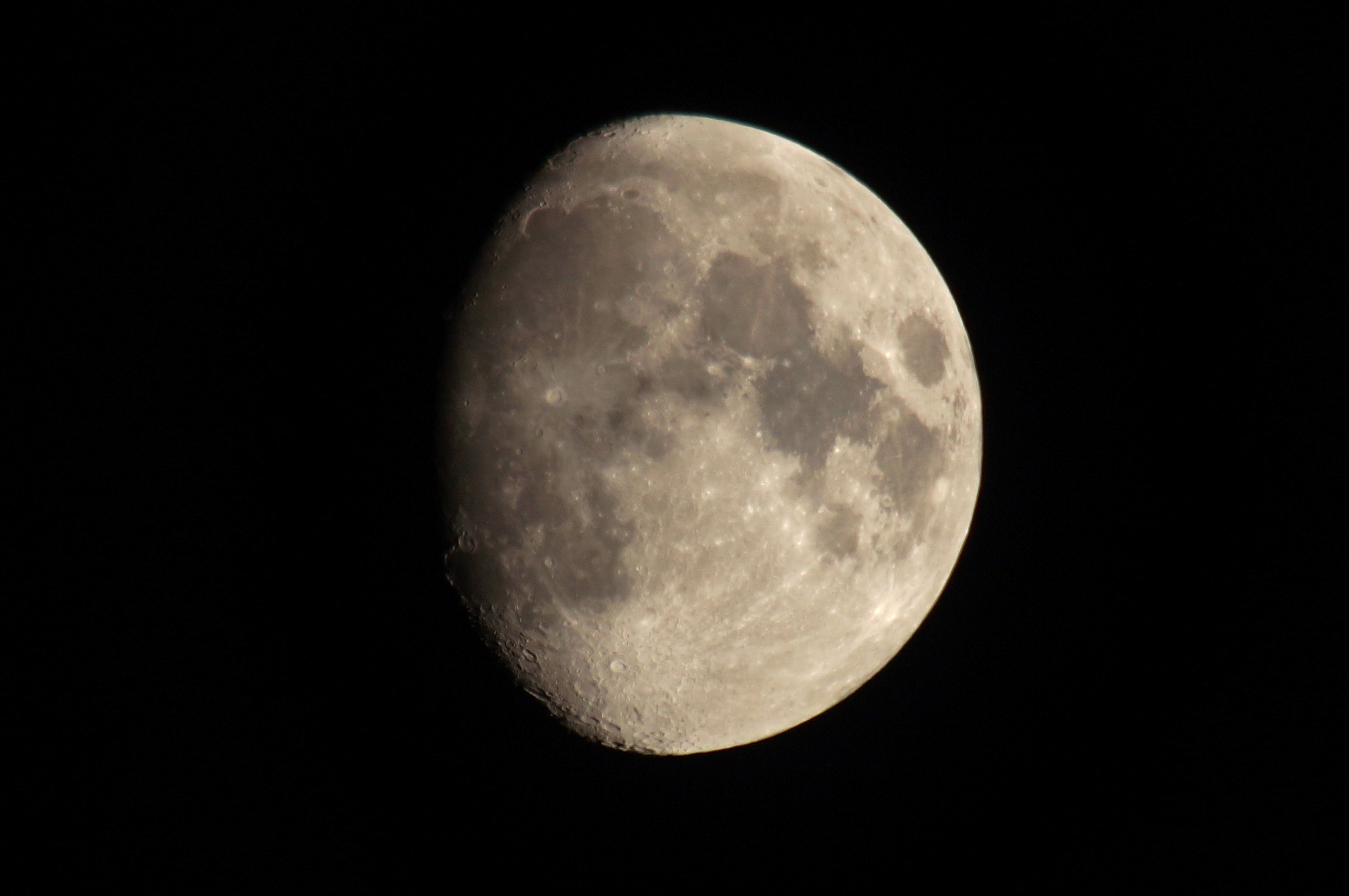

For the picture of the moon I broke all the rules just to see what it would do. It is an untouched .jpg from my EA50. The lens at 3500m, I extended that with a Canon 2X doubler, and I am pretty sure I used the 2X in camera zoom. It should have turned to mashed potatoes after all that but it is not that bad.
Just an option? The moon picture does NOT represent this lens being sharp. Video looks much better than all the magnification I put that still through.
Steve
