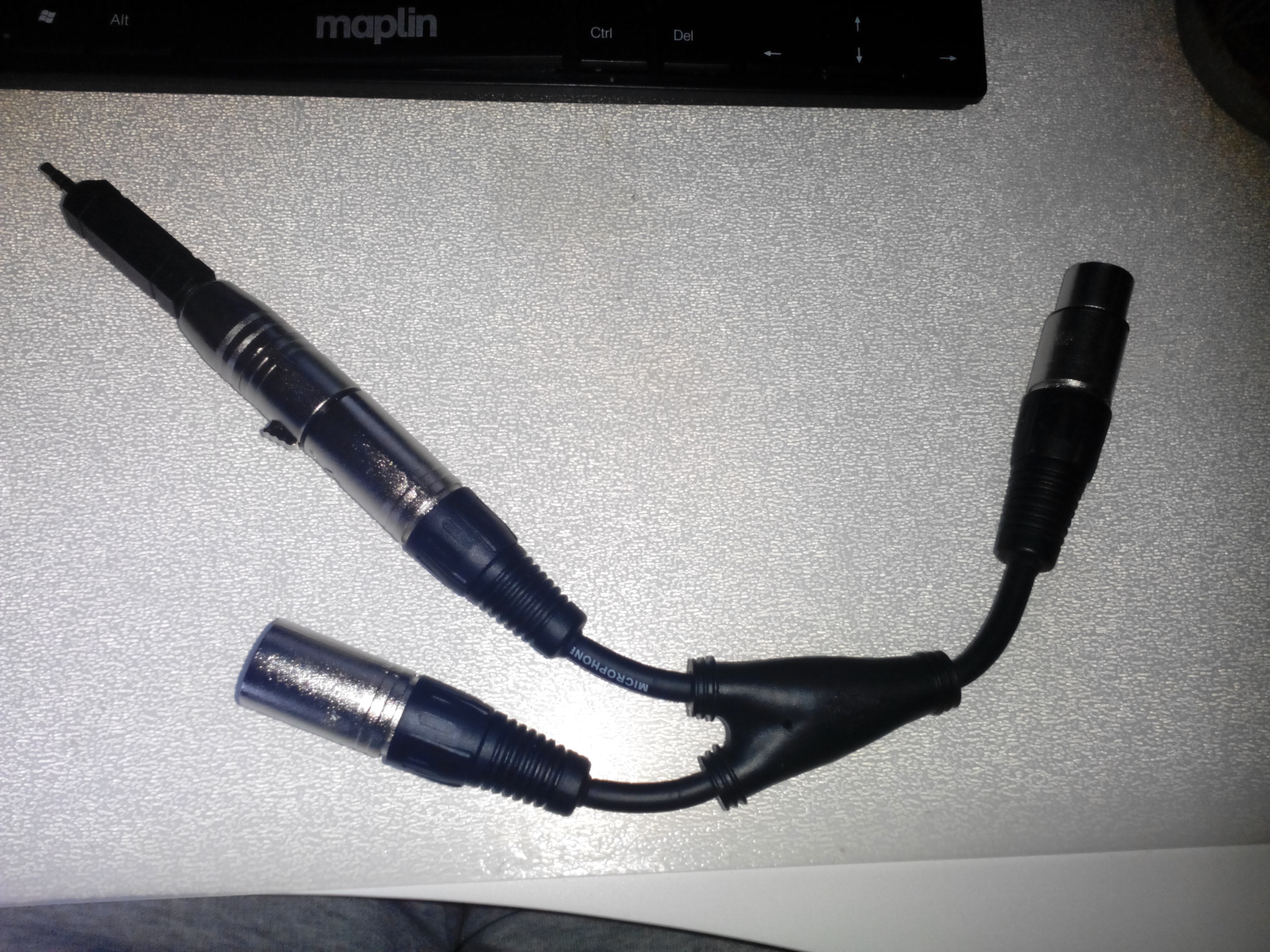

Re: Taping a recorder to a microphone
The only options to 'monitor live audio' like Steven says is a wireless feed going into a recorder on your person, or going into your camera.
Going into your camera for one takes away one of your emergency audio backup recordings.
Secondly - isn't wireless more likely to go wrong rather than the chance of a person accidentally unlocking the hold button and pressing stop.
Third - the above method actually bypasses a lot of issues that are all too common in venues where audio is run by people with no audio knowledge. I've had speeches in a room where the audio was terrible for the guests, but thanks to my recorder - audio was perfect for the wedding video!
Also, I understand a lot of people mention putting a recorder near to a ceiling speaker. A couple of things - how do you check the levels on your recorder when it's 7+ feet up in a light stand. Also - there's no way this recording will be as good in quality as the method in question is.
Like I've outlined before my only alternative method is to sneak a feed from the in-house wireless receiver - but since buying the necessary lead and adapters I've yet to find a venue where this was easy to get at. But I've only had it for the past three weddings so here's hoping things pick up.
Great thread by the way - worthy discussion.

Clive’s XLR splitter is a great tool to have with you. I carry one in a bag with many other cables and adapters. At the venues where he can use it, it will beat a taped recorder/mic every time.
