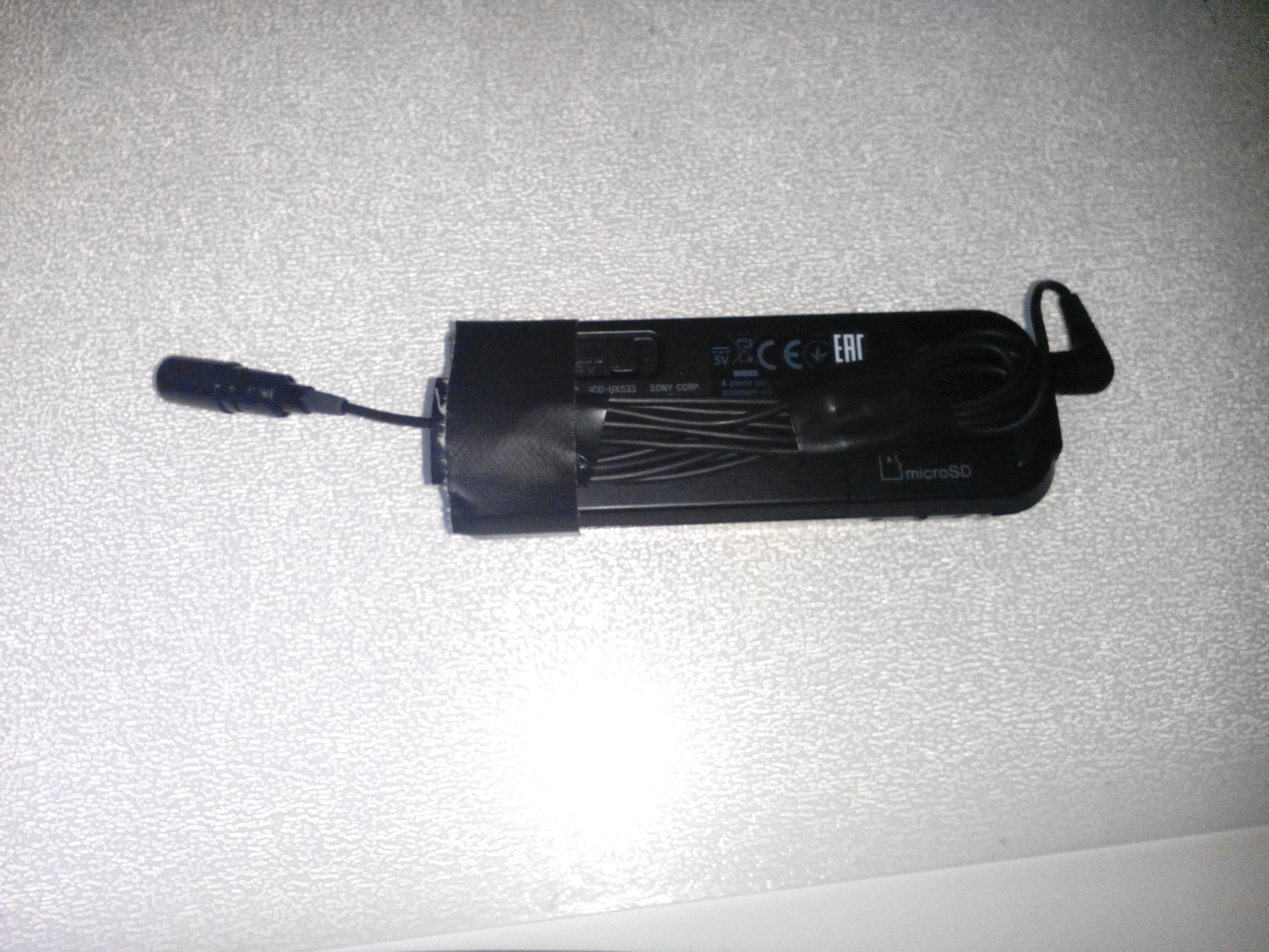

I have just wound up and taped a regular lapel mic without adding too much extra bulk.

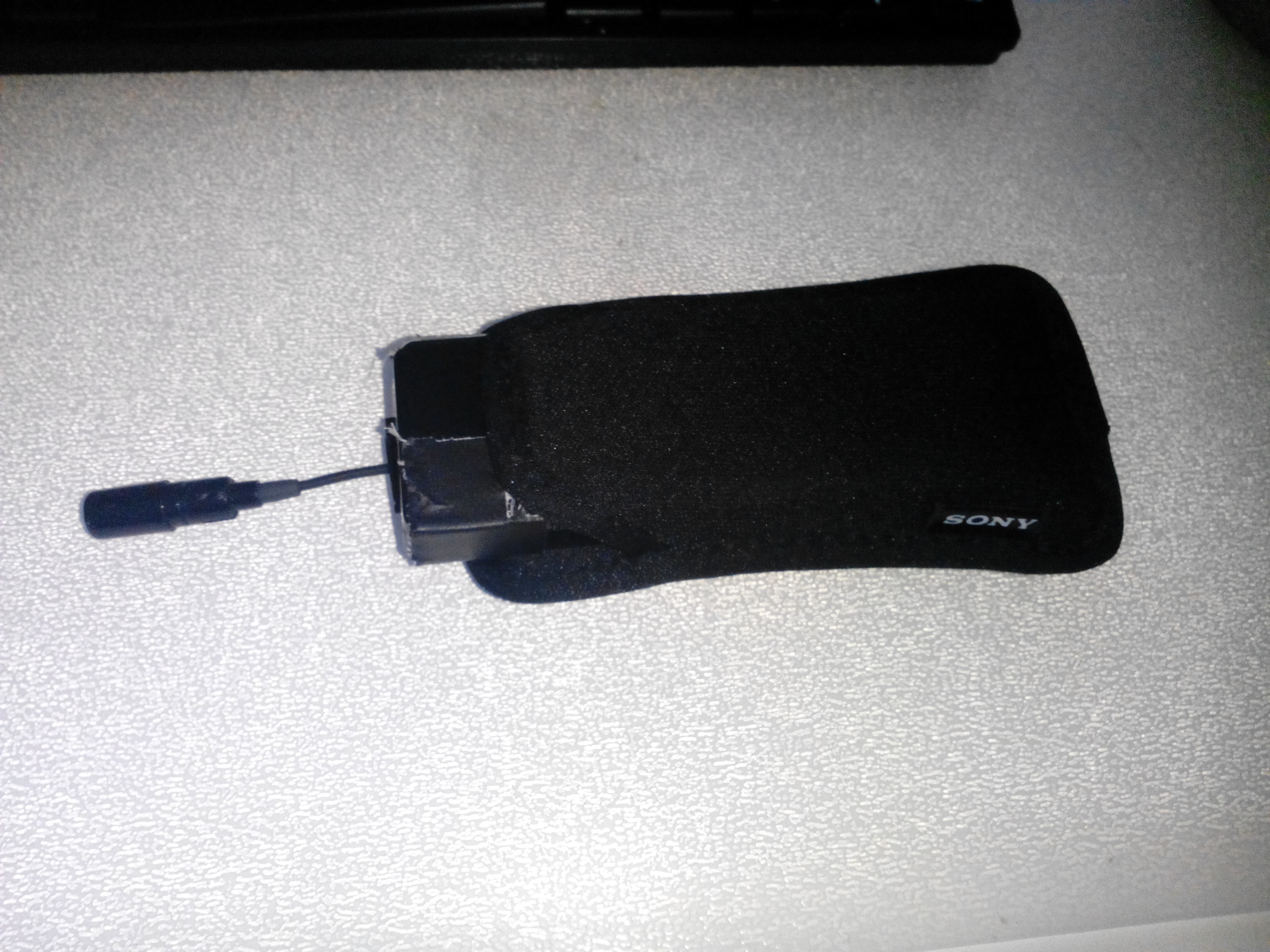

I recently found that the recorders came with these little pouches and I've a plan to sew some elastic fabric loops on to them at top and bottom and then just sliding it onto the house mic. Would be quicker/easier and perhaps slightly better looking than tape?

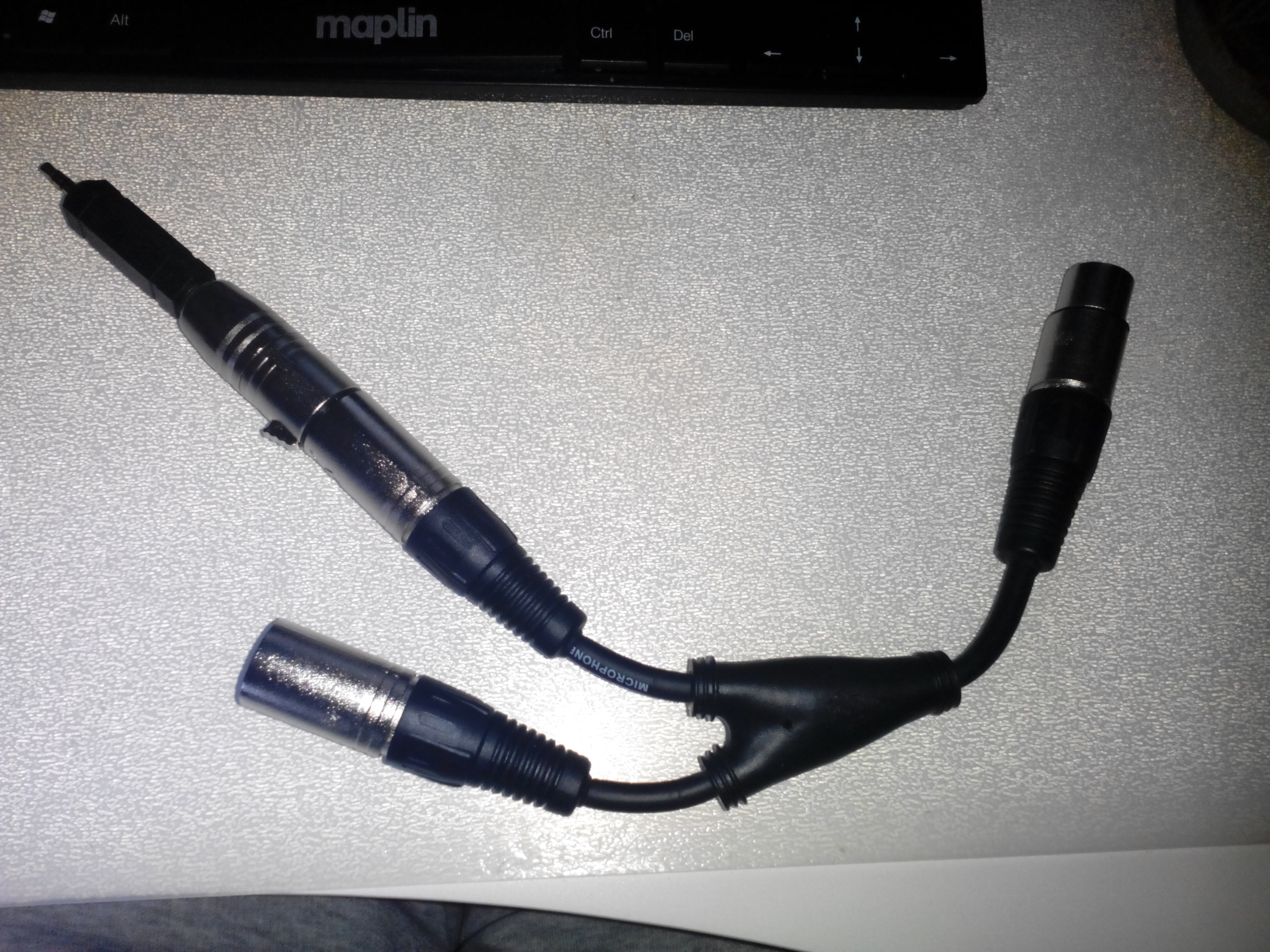

As I said, I have faced resistance on this method and so, on advice I purchased an XLR splitter and xlr-Jack (plus adapter). The idea being to intercept the input from the house wireless reciever into the amp/desk.
Problem being that thus far - venue management know nothing about the sound setup and are unable to show me to the sound setup nevermind point out the correct input to me!
Some people have mentioned (including venues) about tabletop placement for recorders. It's been my experience however that this method is not even really any better than on-board camera audio.
Also - here's a link to my recorders - I'm very pleased with them.
http://www.bhphotovideo.com/c/product/925994-REG/sony_icdux533blk_icdux533_digital_flash_voice.html
Taping a recorder to a microphone-img_20141218_101427.jpg   Taping a recorder to a microphone-img_20141218_101437.jpg
Taping a recorder to a microphone-img_20141218_101507.jpg   Taping a recorder to a microphone-mic.jpg
