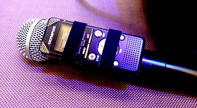

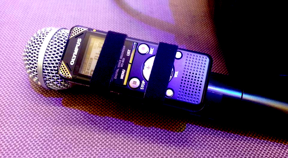

I have done similar things few years ago. Last time when I lost it here in 2013, I got trashed by some guy saying I cannot use dictation machine for that purpose.
Attaching Voice Recorder to Handheld Microphone to Capture Audio | L.A. Color Pros Blog

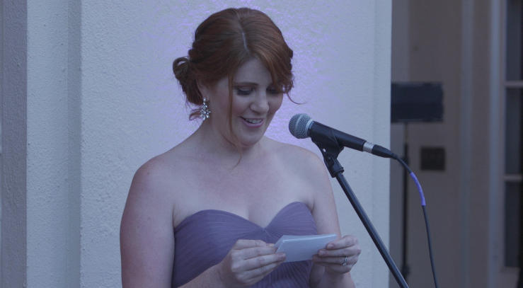

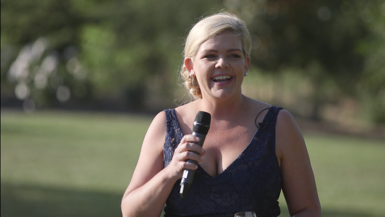

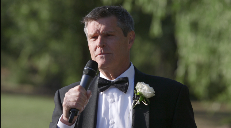

We have tried this method but it doesn't always work out. It's not 100% for us. We have had people take it off, put their hand over it and worst thing is when they don't hold the mic close enough to their mouths. We have found a solution that takes a little more work but is flawless. We mic each speaker with a Sanken Cos-11 and a Tascam DR-10C. The audio sounds more like the quality of the vows at the ceremony, the audio is consistent no matter where they hold the mic etc. We even use Rycote stickies to hide the mic on the ladies dresses but in these pictures we used the clips.
Lady in purple dress has the same setup on her but the mic is hidden!
Now we also don't have to worry about DJ's who won't let us plugin to their system or a cheap audio system that they bring.
I used the Sony ICDUX533B fastened to the mic yesterday and it sounds great - 3 guys and one girl - if It sounds great do it as far as i'm concerned :) As a solo shooter I have little enough time as it is without putting a lav on everyone. I also put white Zoom H1 recorders under each speaker (angled up on little ball heads) in case they decide to ditch the microphone.
When you do this, where do you put the recorder on the females? It's easy with males, since they almost always have a pocket.
