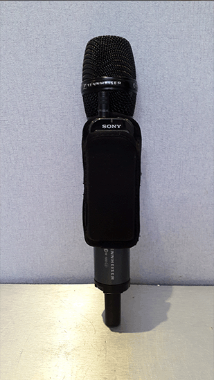

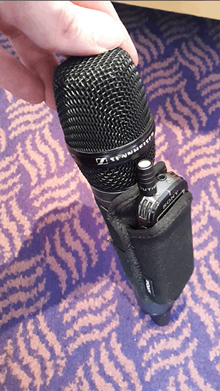

More just for those who may find it by google or whatever - perhaps won't be much of a discussion starter, but I'm happy with both the quality, aesthetics, and simplicity of this solution.
The recorder is a Sony ICDUX533B UX - £55
Sony ICDUX533B UX Series 4GB Voice Recorder - Black: Amazon.co.uk: Office Products

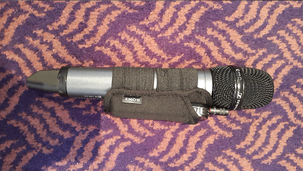

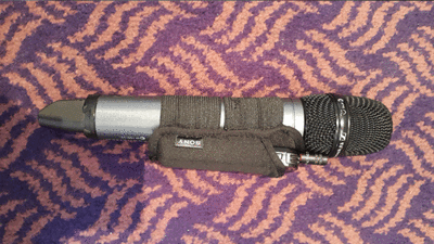

The recorder comes with a slip on pouch. It's fairly secure. I then had my mum sew some black fabric elastic onto it, for sliding securely onto the venue's mic.
The little tiny mic on it is the EDUTIGE ETM-001 - £24
EDUTIGE Dual Microphone ETM-001: Amazon.co.uk: Musical Instruments

Thanks very much for posting that, Clive. That's a brilliant solution. I think it's better than anything suggested in the long thread we had on the subject (http://www.dvinfo.net/forum/wedding-...icrophone.html).
I've been Googling around and haven't found a more suitable recorder and microphone than the ones you've selected, and the holder looks easier to apply and stronger than any of the other means I've tried (hair elastics, gaffer tape, Velcro). It's also a better solution aesthetically, as you say.
One idea that comes to mind -- if anyone wants to use your method but wants to save on buying a new microphone, a less elegant alternative is to use any lav mic, coil it around the recorder, and secure it so that it points upwards. Ray Roman does this when he's micing up brides, for instance (hides an Olympus Recorder WS812 in their bosom). External microphones definitely will give cleaner sound than the inbuilt microphones.
Another thought -- use of thick fabric elastic potentially hinders access to the on/off button and to the display screen. But I guess you can push through the fabric to turn the thing on/off, if that's where the button is, and most of the time the user won't need to see the LCD display.

Yea Adrian - I previously used a lav mic coiled up when I did this method with tape, but this little mic means less bulk and hassle. I have to say though, my audio tests showed my lav mic performed better than this mic - but darn it, it's cute and very simple!
You are right - the elastic does cover mic buttons and switches, but as I've told venue managers, the fabric can be push pack to gain access. On one occasion I just explain to the manager that he could slide the whole pouch down the mic shaft, make his adjustments and then slide it back up. He felt this was no big deal at all and was very obliging.
