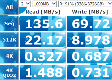

Just one last benchmark on the RAID5, after having freed up 300+ GB and disabling write-cache buffer flushing in windows. Will compare this to the RAID0 scores, hopefully tomorrow after my HDD arrives.
It's a clear boost in speed, but still horrid. Those of you with a Black drive, feel free to post your own scores in Crystal Disk Mark. I ran it at 1000MB and 2 passes. Just curious :)
Luc Spencer is offline   Reply With Quote
