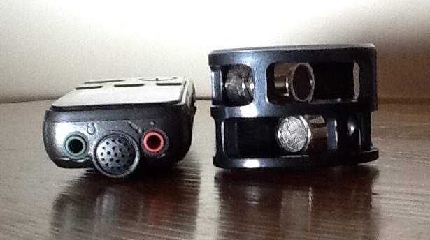

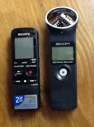

I have a couple of Zoom H1s and a couple of Sony ICD-PX312s. The Sony's only record MP3, although there are other versions in the same body size that record WAV. Personally I think that MP3 is very acceptable for recording the vows if you use the higher settings. Some people get vey precious about wav for audio recording, but mp3 is good enough for millions of MP3 players for music which I think is more demanding than basic voice recording. Anyway, never been a problem for me.
In my opinion, the H1 is too bulky for an inside pocket, whereas the Sony is much smaller and slimmer. I have attached a couple of grainy pics taken with the iPad to give an idea of size difference.
Roger

Could only upload 1 pic, so here is the other.
Roger

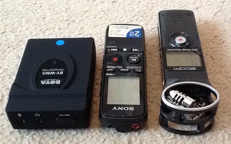

Hi Roger
How bulky are your 2.4Ghz wireless transmitters in comparison to the Sony Recorders??? I usually run a lav cable inside the jacket and drop a transmitter into a side trouser pocket if the breast inside pocket is too tight a fit ..It is still hidden there!
Attached a pic to show relative sizes of Sony, H1 and Boya TX. The Boya is thinner than the H1 and slightly thicker than the Sony. Shorter than either and about twice as wide a both. It fits into an inside pocket with no problem and nobody has queried the size. Being a regular shape probably also helps and there is a belt clip if you want to attach it elsewhere. I thought you had already ordered one?

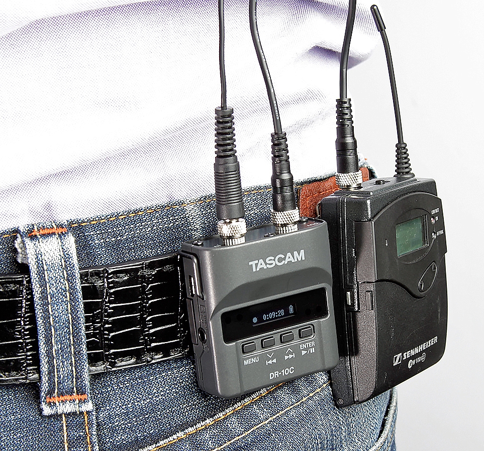

I've thought about this type of solution for a long time,

Posts: 8,441
Re: Need New Audio Solution
Hi Steve
Problem is they have to be on the side not at the back otherwise when the groom turns towards the priest/officiant, the transmitter is in the shot and on the side they also tend to bulge out the jacket, especially if it's buttoned up. I did it once and it looked ugly on wide shots!!
