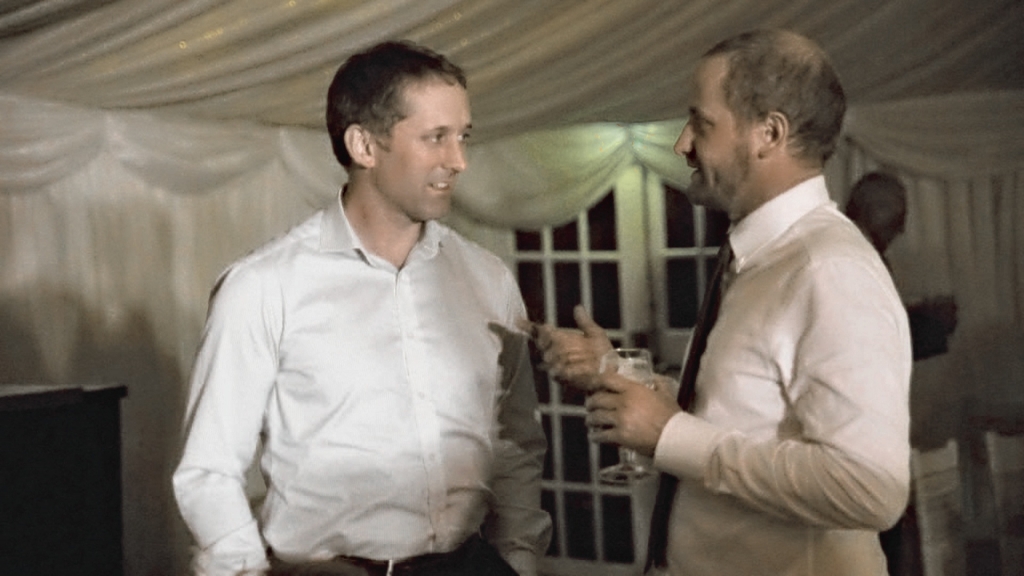

Old October 30th, 2015, 08:58 AM   #34
Location: Sydney Australia
Posts: 1,622
Re: What gives with these lights

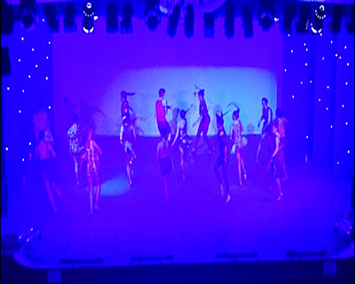

Originally Posted by Peter Rush View Post
I could find no WB temperature that made them look vaguely human!
That's bad... worst I've seen. I wondered if it was at all salvageable. With a bit of massaging in post it could be pulled back to some degree of normal. It could look more like this? I suppose one could leave some blue in the scene if you wished.
Chris Young
CYV Productions
Sydney
What gives with these lights-led.jpg   What gives with these lights-blue-led-more-like-.jpg

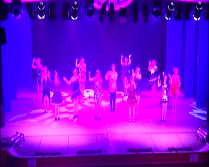

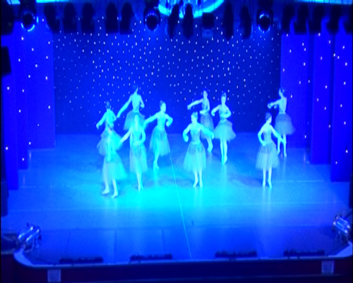

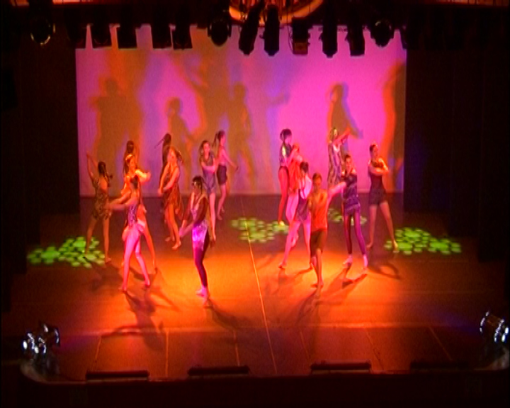

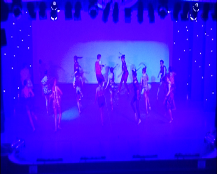

Old October 31st, 2015, 04:44 AM   #35
Location: Lowestoft - UK
Posts: 4,090
I just grabbed these images from a show a couple of weeks ago - one of my cameras is fixed in a position and simply feeds a couple of video monitors backstage - fixed focus but left on auto exposure, in this case on the spot setting which closes the iris a little to compensate for the typical theatrical hotspot scenario. The magenta lighting and the blue are simply horrible. The trouble is, they look really nice to the eye - the JVC camera (a 5100) has real issues with these two colours - the mixed lighting image is fine, and looks very similar. In my job I also shoot stills on DSLRs (not video) and I updated one and the newer one also has colour issues - not this blowout - but it finds red through to blue very difficult. It has issues with accurate rendering of these colours - they all seem identical. The older camera is fine.
