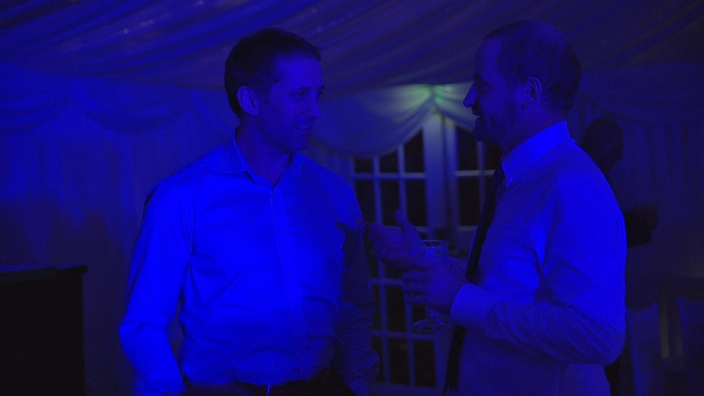

From yeaterday's wedding. The DJ had 2 banks of 4 X LED lights (big circular things) and they were the only source of light in the marquee, washing saturated blue over everything, I've never seen lights so intensly coloured like this before - I could not expose properly at all unless I went really close to the subject and blasted them with my own LED light.
What I found really strange was that when my camera thought the shot was correctly exposed, to my eyes it was way over, there was no detail in the guy's shirts - I had a little time so I hooked up my smallHD monitor and took a bead on these 2 guys - they both had white shirts on so I took the gain up until I saw zebras just coming in on the brightest part of the shirt (set at 95%) and in the montor all the detail had gone from the shirts - they were simply a wash of blue, so dialling down and letting the camera think it was about 2 stops under exposed I finally saw detail coming back.
Also I tried a manual white balance on the shirt - looked aweful and then dialled through the Kelvin scale and again - I could find no WB temperature that made them look vaguely human!
Putting my light on fixed things but is far from desirable as I had to get really close - nightmare - worst reception lighting I have ever encountered!

Very similar experience I had with last year with them DJ's. They don't give a rat's a&# about the video and I had one that just did not limit his blue wash. I really don't get what they are intending to achieve with that particular color and the only guess I have is getting that "black light" look where everything that is white will really stand out. The one I had experienced with last year I solved the problem on the spot. I simply showed the bride a few clips of that garbage and told her that is what she will get and she immediately went up to the DJ and after a few short words all went back to normal for the rest of the evening. I really think that talking about the DJ should be mentioned or at least be part of the clauses in the contract that frees us from their lighting extravaganza being recorded. If the bride says it's OK and she prefers it that way, I would make absolutely sure I record her saying that when i bring it up at the venue.

Those Colbalt Blue LED lights are the worst of the bunch! The only thing you can do is get in a close as you can and light couples with an on camera light ..of course the background and any wide shots will still be blue!
I have actually seen footage where the image posterises due to the lights. I haven't had any issues with red lights like Noa has ..only the blue ones.
However I have never seen it that bad! Maybe the A7S is just too sensitive in low light so it picks up every scrap of blue in the room?? Yeah, hopefully all the footage is not like that. That was one reason why I started dropping my packages from "end at midnight" to "end after the first dance" That way the DJ lights don't affect me but if you have the marquee lit like that from the start, there is not much you can do!!

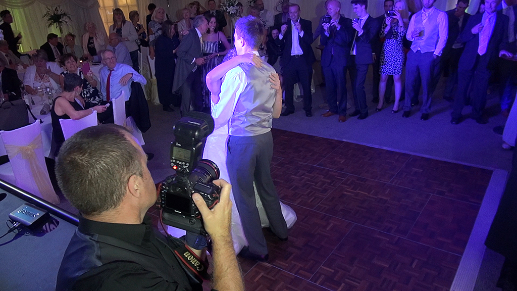

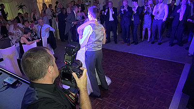

Here's a shot from my CX730 with an LED-5080 light on full - still didn't make much inroad into the blue light

But you can see that the cx730 deals a lot better with the blue light, at least it looks better from a distance but I might be wrong, I think it's a typical a7s problem that it can't handle these kind of blue led's well. The led lights are much more powerful then a videolight, you almost need to stand next to your subject for best effect.

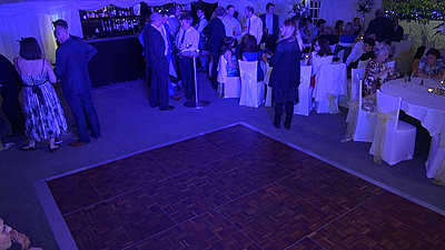

This is from the CX730 set to auto exposure but minus 1/2 a stop with no additional lighting from me - just the DJ horrible lights

Still I find the blue with the a7s much more harsh.
