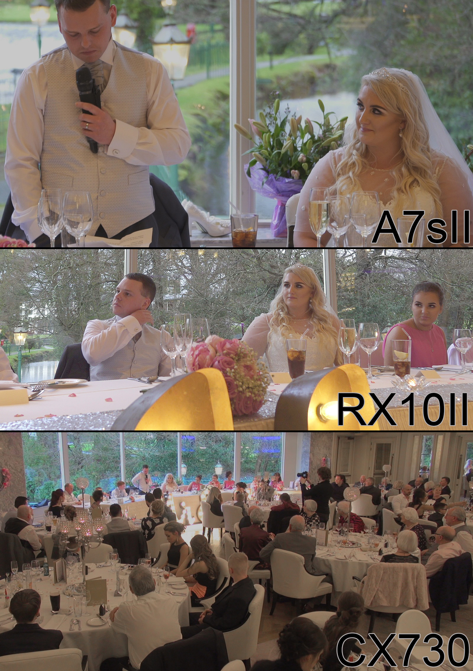

I made up a screenshot comparison (after grading), so maybe you good folk can give me your thoughts.
Is it below par? Would an AX100 raise the bar adequately? Or am I worry too much about one fussy client?

Showing an example of a shot from each camera doesn't really give a great insight into what they might be unhappy with. If all three camera shots are basically unchanging throughout the speeches, then it might be down to being unexciting as you suggested. Speeches are boring from a visual point of view and you need to be very imaginative with your manned camera to try to keep it more interesting.
If you have wireless connectivity with backup cameras, try varying the zoom so that the shots are not the same each time you cut away. Even with HD footage, you can still get away with small ammounts of cropping and frame zooming in post to add a bit of movement. Perhaps the occasional PIP or split screen to show both speaker and reaction at the same time, anything to add variation.
I would be surprised if the negative comments were about the technical quality of the footage unless they are very technically minded.

I don't see anything wrong with the cx730 shot, you might sharpen it up a bit more to match better with the other camera's but other then that it just looks fine, you just have a bridezilla, no-one should tell you how to do your edit unless they are paying for a custom-made film.
