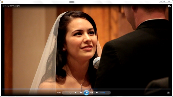

For focal lengths, I change lenses during the ceremony. So my rear camera is often a full frame at 85mm, and up front cameras start at 18-135 STM, then use 55-250mm STM lens (on my canon 70Ds, so a 400mm equivalent).
Why? So I can get a lovely over the shoulder close up of both the B&G during vows and American churches are big.
These exact lenses are used because STM are smooth and silent focusing on the 70D. For things like the processional, its glorious. Tap the bride's face, and she'll be in focus the entire walk up the aisle.

That's really impressive in terms of the continuous focus. I envy your ability to move during a ceremony. Often, I am locked in a corner with nowhere to move! :)
