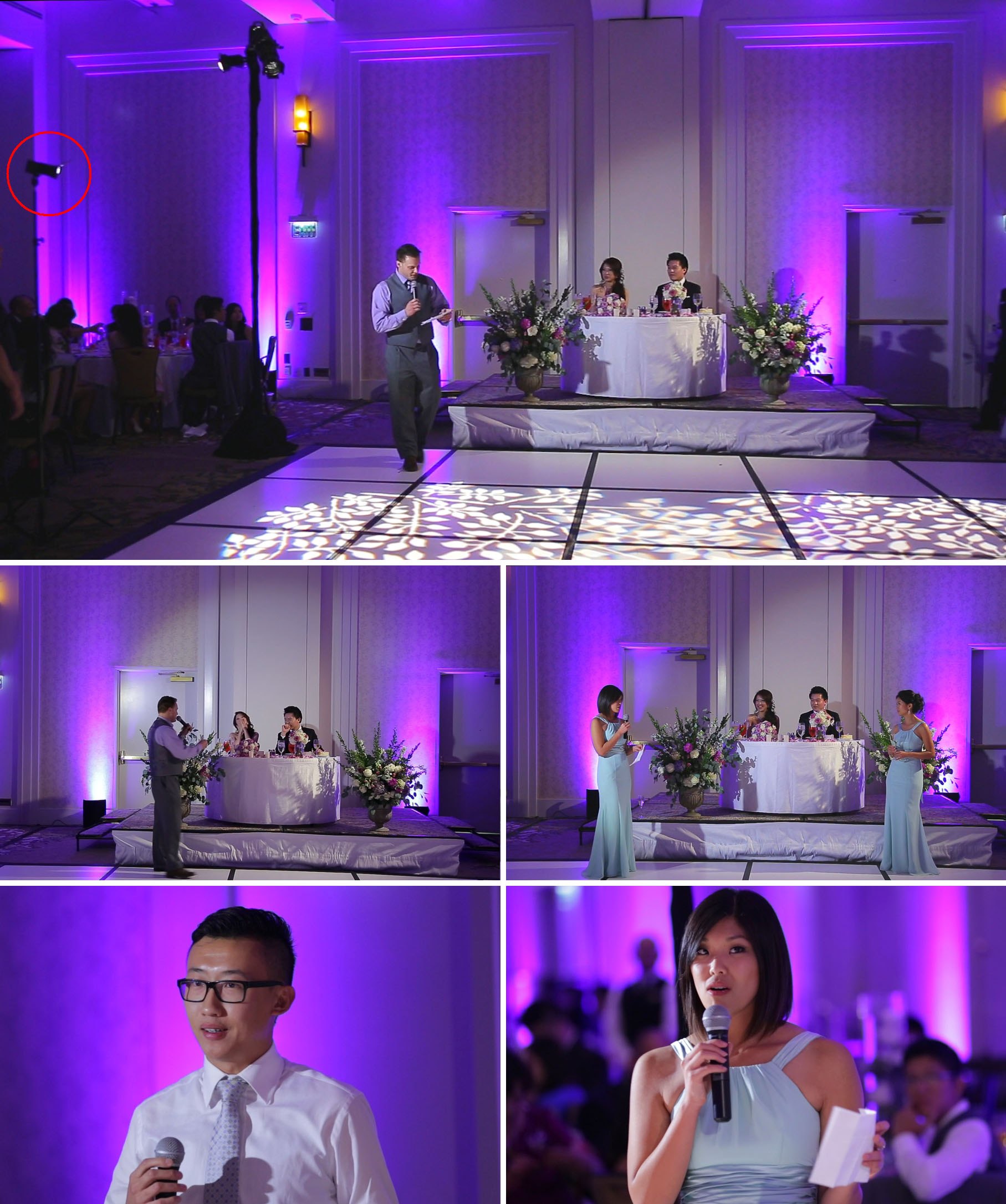

I myself use Comer 1800 light (and I'm a reseller). The best feature of the light is the spot filter. And there is a trick to turn the light into a really narrow strong beam. But for wedding reception, I like the way it cast a stage style spot. It is still a general purpose light but not a spot light (can't control the size of spot). But I like it.
Best Light for wedding reception/speeches-comerspotlight.jpg
