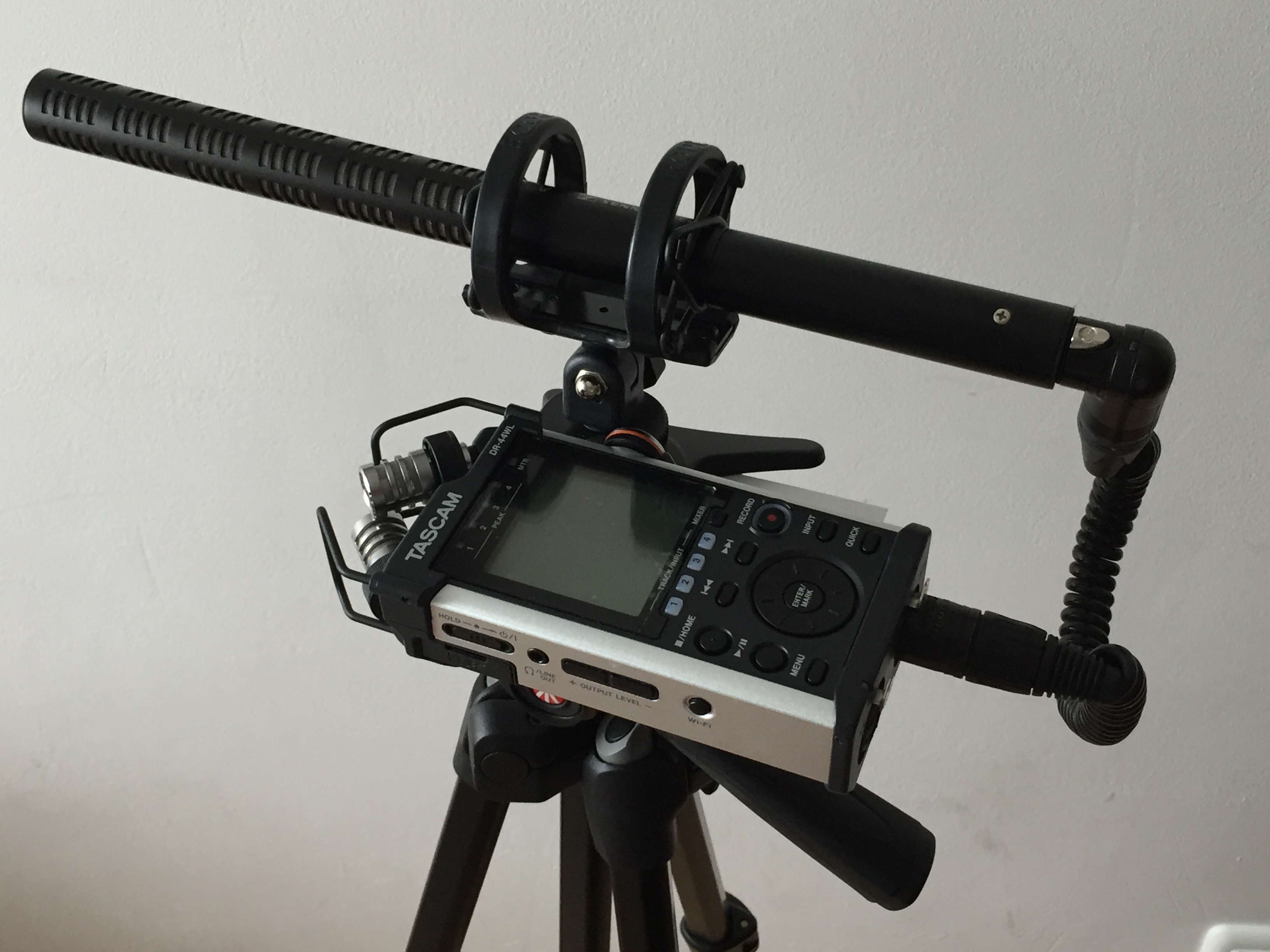

Audio
A really tough problem. My plan was to put the mic with the recorder on the tripod. I made up a support to put the two together and run the recorder via wi-fi remote using an iPhone and the Tascam app. The app allows one to see the VU meters, turn the recorder as well as individual channels On and Off, and adjust the gain of any of the tracks on the fly.
In my first test with the mic I had the db average set at -12db but upon transferring the file to the computer it was found that the signal was way too weak. Then I increased the gain so it hardly ever clipped and the file signal was nice. After dialing in the VU levels before the shoot the plan is to engage the Limiter function to handle the peaks and then just concentrate on shooting the video. Recording set to *.wav format, 16 bit 44.1k mono.
The Tascam and the cams have their time codes synced within a second or two and fresh batteries in everything.

Update: Just took care of the need for a second tripod for the mic and recorder so just bought one. Picked up another memory card for the recorder so lots of file storage space there. I feel I'm covered on those fronts now.
