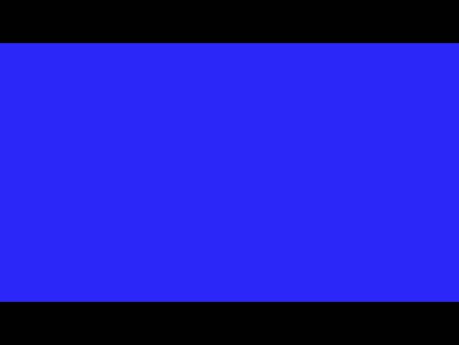

Simon:

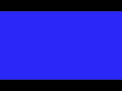

I am attaching mask I use. I am not guarantying it is exact aspect, but you can make your own in Photoshop. Load the mask on your memory chip and put it in camera.
For the VX2000, I would then start camera up in 4:3 mode, select memory mix. In the lower corner, you will see the current image in memory. Hit the + or - next to memory mix to go through available images, until you hit the mask. Make sure memory mix setting is using M.Chrom by using selecter wheel at back of camer. Once you got image and m.chrom selected, press in on selector wheel, and the two images will mix, leaving you with black bars at top and bottom, but still with a 4:3 image.
16.9/4.3 aspect-16x9mask.jpg

Thanks mate.
I will try this out.

Enjoy this large collection of mattes
Sony DCR-TRV350 Digital Handycam / DCR-TRV351 extra images!
and contribute your own at
Flickr: The Memory Mix, insert Sony DSC TRV350 images! Pool
