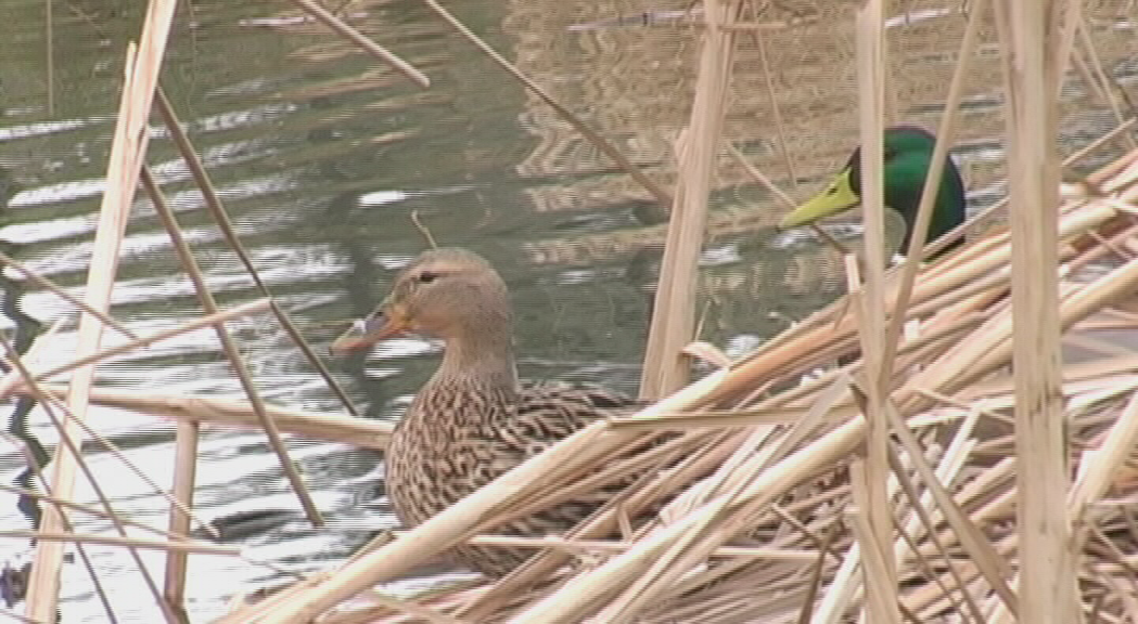

Graham, if you're still following this thread, would you do us a favor?
Would you, please, post the original images in their "raw" state, without any correction or changes, other than one in 8-bit and one in 32-bit using the 2.222 mode?
Your wish, Jay, is my command.
They ALL look the same to me? What is being ascertained by me doing this? Please let me in on the secret.
ALL 3 options: 8bit - 32bit Video 2.222 - 32bit 1.00 Linear - NONE having any FX-ing.
Grazie

Attaching is going wierd on me . .
Trying again.
G
32-bit and 8-bit comparison ..-8bit-no-fx.png   32-bit and 8-bit comparison ..-32bit-no-fx-linear.png

1 - Source - PAL SD
2 - Eh? I can tell you what I've done?
3 - I tried to upload 3 at once. Now trying to do one at a time.

Jay? can I give you this last one for YOU to load? I can't load it!!!
I've tried 3 times now, and I'm being told I have ALREADY uploaded it!! The WIERDNESS is that the UPLOAD manage attachments is telling me it is already loaded - ERROR - but I have even renamed it?!???

There is no difference when dealing with DV. This is why I created the HDV projects for you to compare.
You'll see a diff in SD when you color correct and push color; the banding normally associated with pushed DV/8bit disappears.
Exactly! What I said was that AFTER doing Fx-ing, and compared to 8bit, the 32bit results just lept out at me. And yes colour push and BANDING will be "smoothed".
It was this extraordinary result I got from using 32bit applied to my Fx-ing that thrilled me.
Oh, my mistake about the levels differences being the cause of why things look different.
For DV footage, flipping between a 32-bit (2.222 or 1.000) and 8-bit project won't cause the codec behaviour to change like with HDV footage.
However, flipping between 2.222 compositing gamma and 1.000 will cause the behaviour of the filters to change since they are being fed with linear light values instead of gamma-corrected. That should be what you're seeing. If you flip into 1.000 compositing gamma it should look extremely similar to 8-bit.

That's what I wanted to see. Somewhere, I read something that led me to believe that the 32bit alone added some visual improvement. Not having it installed yet, makes all this most difficult to grasp.
Thank you, Graham, for your effort and patience!
My pleasure, dear boy! My pleasure.
Actually, not wanting to bring further rain on me, from those who know far more than I will ever know, I can see a very small difference in the RAW. The PINK blush in 8 is not present in 32. The detail and colour "hold", appears to me, at least, more restrained and exacting in 32 RAW. Do have a closer look at it. Colours in 8 seem to be "creeping" not in 32.
OK - When Glenn first put up his Tute, I ran to it; experimented and got this eyeful of possibilities; wanted to share my experience with it and hopefully entice others to post their reactions to it with maybe some of their examples.
My problem now is to determine - post-enthusiasm - just when and WHERE I would apply this. I say this, 'cos my CPU takes a big hit from all the maths going on.
